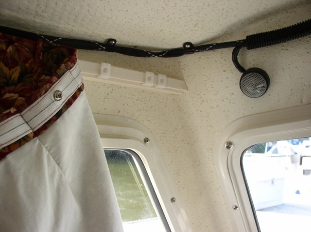

When Nanci and I made the curtains, we wanted to be able to leave them in place, for a homier feel. We used the snap tape made by Recmar, (from WM), and made tracks to fit the CD. Very happy with the results.

Matt, you can see the tracks I made in the picture above. They are made of Azek plastic lumber, cheap and easy to work. Just takes several passes on a table saw. Caulked to the hull with hot melt glue in spots to hold it till the caulk sets. Don't forget the masking tape. There's a few more shots in my album.

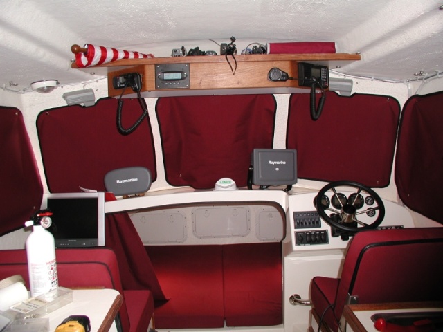

Here's Sunbrella cut to fit with piping and reinforced corners. From Janet's canvas shop (sewing room). The snaps have a 1/2" screw and replace some window screws.
