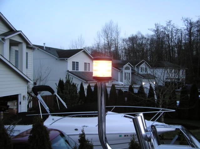

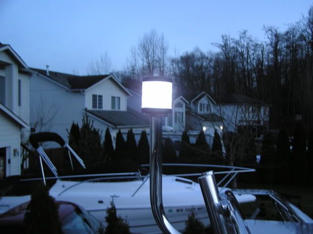

Got home from work and a small box was delivered from marinebeam.com. Waited until it started to get a little dark and installed the anchor bulb.
The new LED in the Aqua Signal fixture:
The old bulb:
The light is MUCH whiter and the bulb is brighter; all for ~$30. It has 30 leds so it's 360* of light being emitted. They sent me the wrong interior lights though. I called and they are sending the correct ones that I ordered w/ a return postage label for the others.
