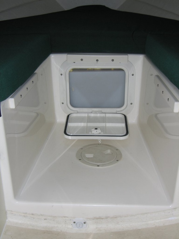

Here’s a larger hatch to the water tank on my ’05 CD25. The tank now has marks drawn to show number of gallons remaining.

Jay, where is your water fill ?
Anyone with an '06 KNOW where there tank is ? Is the '06 the same as the '05 ? 'As The World Turns' so do the the questions arise. Razz
Socrateur
Joined: 16 Feb 2006
Posts: 244
City/Region: Danville
Vessel Name: Sea Skipper
Photos: Sea Skipper
PostPosted: Wed Apr 28, 2010 2:48 pm    Post subject: Reply with quote
Water fill on port side gunnel below the running light.

Toyman, the tank in our 25 is in the bow, I cut hatches in the top of the berths and dug out all the foam, now the tank in front is visable to check the water level, the little screw in one on the v-berth face looks good for lower levels too. Very simple and more storage space and a spot for a 2nd simple depth sounder transducer epoxied to the hull. (No hull core forward of the bulkhead)
