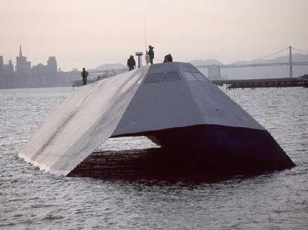

HOW TO MINIMIZE YOUR RADAR SIGNATURE TO OTHER BOATERS...
We encountered this Navy Stealth Research Vessel on the Alameda Naval Air Station nook of S.F. Bay in 1993 while practicing racing sailing techniques.
This was one of the first days they had taken the stealth boat out on the bay. Before that, it had been tested in a test chamber / closed in building over in Redwood City.
One look and we knew it was a stealth boat, looking much like the F-117A stealth fighter, or a Star Wars movie prop.
It illustrates many of the points made in the discussion in the posts above.
