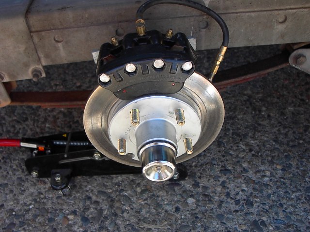

I have used kodiak stainless disc brakes on two trailers and am very happy with them. Also, this is the time to install electric over hydraulic brake actuator. I have used three different brands but I like the Titan the best. Once you go electric/hydraulic actuator, you won't go back to surge brakes.

Tie-Down is adequate, IMHO, for freshwater and moderate use, from my experience rebuilding my own trailer. (Photo below.)
Kodiak has at least three grades of brakes, the highest of which has stainless steel rotors, with some bronze parts that are more easily manufactured from that alloy. Much better in salt water.
The general opinion is that Kodiak brakes are a superior product to Tie-Down, and the price reflects it. Tons of comments on these two (and other) brake choices on The Hull Truth
Tie- Down brakes are available inexpensively at Champion Trailer Parts Supply, as are all types of trailer parts at minimum cost! Check it out!
It would be interesting to figure out just how much it would cost to upgrade/rebuild a used trailer to reasonable quality standards. I spent about $1000-$1200 renewing the brakes, surge brake controller/coupler unit, bearings, wheels, tires, lights, a few rollers, recovering the side guides, and replacing a few bottom rollers and all washers and keepers on my roller trailer unit. At some point, it would be just as economical (and easier!) to buy a new unit! Best cost-wise, of course, is to get a good used unit with most systems already adequate, and not requiring rebuilding, but with a used boat, you don't get a choice of trailers, usually, so figure in the rebuilding costs when purchasing.

My Tie-Down installation (shows some wear on the rotors).
