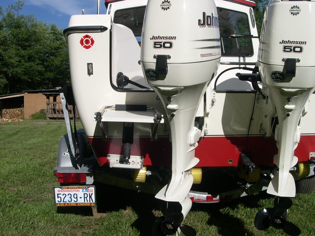

Is it possible to mount twin 40's on a CD22 far enough apart to fit a swim ladder in between? I'm guessing there would be a steering control rod that you would have to step over?
I will be single-handing the great loop and would like as much motor control as possible. So I thought if I could separate the motors, even with a custom bracket system, that would allow using the motors to steer in awkward places.

Between - probably not.
To the side - it's been done. The step is slightly smaller than stock, but works just fine.
Use the search, enter swim step for the terms, and DaveS for the author - you'll see plenty of posts on the above.

As to the other portion of your comment/concerns e.g. single handling a CD 22 with twins - that's easily done with the standard mounting. Adding a bracket to get the engines a little farther apart seems like a very expensive solution to a non-problem. Many of us single hand our twin equipped CD 22s frequently and I'd bet none of use ever had a desired to have the engines farther apart to improve maneuvering. The only time things can get a bit tricky is approaching a dock in a cross wind that takes you off the dock - these boats have a fair amount of windage and not much boat in the water so they blow off the dock quickly.
