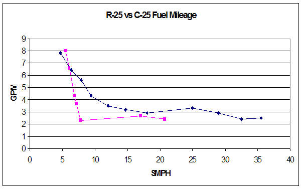

OK, to show the comparative economy between a C-25 and an R-25, here's a chart. The C-25 MPH figures are from a Honda test. The R-25 figures are from the numbers for Little Toot, posted above. They seem to show the difference between a lighter planing hull and a displacement hull, at the higher speeds. First time gas is more efficient than diesel. Any explanation?

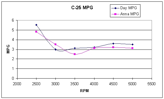

Here's another for Anna Leigh and Daydream, just for a check (both C-25's, with Hondas.)

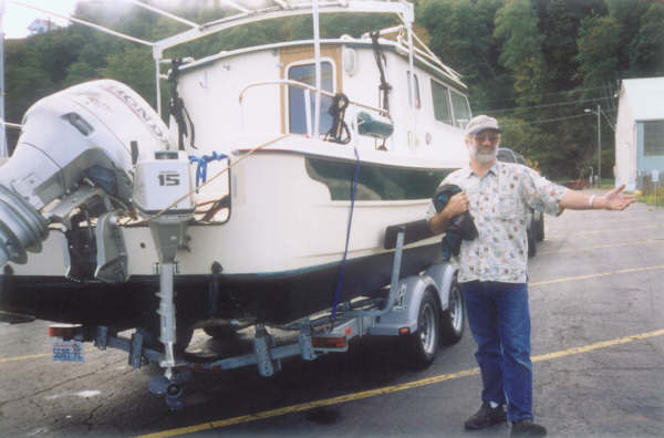

Also, though, the tug hull is more of a displacement boat, whereas he CD-25 is more of a planing hull, so the transition to the planing mode for the CD is more gradual and smooth, as opposed to the more abrupt change in speeds and mpg with the tug which is at first reluctant to get up on plane.
R-25 Tug with 1/2 tunnel drive and deeper "v-ed" hull than below (Photo Credit: C-Ranger Boats)
CD-25 with flatter hull and proud new owner. (Photo Credit: TyBoo)

I am a little surprised that the C Dory 25's are getting over 3 miles a gallon at the higher RPM's. It looks almost like a flat curve--with no difference of fuel consumption at 4000 to 5000 RPM. What speed does each RPM range equal?
Boris, do you really mean GPM?--if that is a really big "sucking sound".
But 7 gallons an hour does not sound high to a lot of people when you are up at a planing speed with that size of boat.
Definately the C Dory planes easier, with less HP.
PostPosted: Wed Feb 27, 2008 7:21 pm    Post subject: Reply with quote
Well, Bob, isn't GPM gallons per meter?
Sorry, indeed it's Miles per Gallon, MPG, and I'm not going to change the chart annotation. Used to have a professor in Fluid Flow who would give a F if you got the units wrong. Guess I wasn't his best student though I did learn the difference between the weight of a cubic foot of water (62.4) and 2g (64.4.)
As to the flat MPG curve after it's up on plane, Joe, I'm just the data processor. The boats were probably nearly empty.
As to weight, Journey On weighs ~7000 lb. after Judy loads it. 2.5 MPG is about the worst I've seen, bucking wind waves. 3 on smooth water at 15 knts.

For the CD 25 with the 150 Honda: the best fuel economy occurs at 3500 rpm: 15.4 mph= 4.05 mpg; 18.7=3.6 mpg, 23.4mph = 3.71 mpg; 27.2mph=3.36; 31.3 = 2.85mpg; 32 mph = 2.44 mpg
In the graph above, Anna Leigh only gets 2.5 miles a gallon at 3500, where and then the miles per gallon increase to over 3.2 at 4000, and slt better at 4500 and 5000. Where as Daydream gets the 3.0 miles a gallon at 3000 RPM, and goes up to over 3.5 at 4500 and 5000 RPM. They do not show this one dramatic place where the fuel mileage is exceptionally better--and I suspect it relates to weight, engines, and propping of the various boats. Definately the Ranger tug shows a big hump--which is much less in the C Dory
