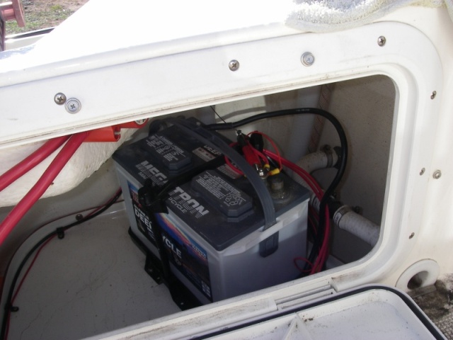

OK, so what kind of wires go from the Vector 40 amp charger in the vee-berth to the batteries (presumably, in the back?). If the batteries are not in the back, what kind of wires go from the outboard to the batteries? Don't they have to be pretty honking wires, especially for the initial current draw for starting the outboard?
Also, I guess I should look at Boris' setup, but even the small Optimas are a tight fit where C-Dory installed them, and given their weight, I had a bit of a difficult time lifting it out clearing the battery switch, had to turn it end-wise to remove, and then it just barely cleared without shearing the battery switch off. It physically measures 7" wide x 10" long x 7" tall.

Pat-
Pat Anderson wrote:
OK, so what kind of wires go from the Vector 40 amp charger in the vee-berth to the batteries (presumably, in the back?). If the batteries are not in the back, what kind of wires go from the outboard to the batteries? Don't they have to be pretty honking wires, especially for the initial current draw for starting the outboard? <stuff clipped>
With the charger up in the v-berth, I simply removed the big alligator like clamps from the ends of the charger leads, swedged on some large solderless ring terminals, and tied these leads into the studs on the windlass solenoid where the 6-gauge wires come forward from the rear of the boat to the windlass solenoid, which is on the helm firewall. The leads from the two forward batteries also lead to this same solenoid from their switch and battery boxes under the forward port seat under the dinette. The whole point is to parallel the battery charger leads into the batteries and to save wiring by tying them into the existing wiring leads for the windlass coming forward from the rear of the boat. One could use a busbar for these large terminal connections if preferred.
Hope this answers your question; if not, ask for clarification.

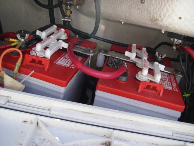

Let's see, I'm not certain that I understand how a battery charger can get in the v-berth. As a result I uploaded some photos showing Journey On's battery, battery charger and switching/grounding installation. Here they are:
This image shows the golf cart batteries installed. I had to get another battery holder, just like the ones that came with the boat. Moved them around so both batteries would fit, and I could check the water. One has to lay the batteries on the side to get them in, but it works. Tied together to give 12 VDC.

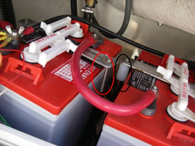

This image shows the way I modified the hold down to accommodate the new batteries. Cut the top off the hold down bolts, drilled a hole into the ends, and used a long bolt. The red ellipse shows the bolt and new strap. The black ellipse shows the 1 1/2" spacer.

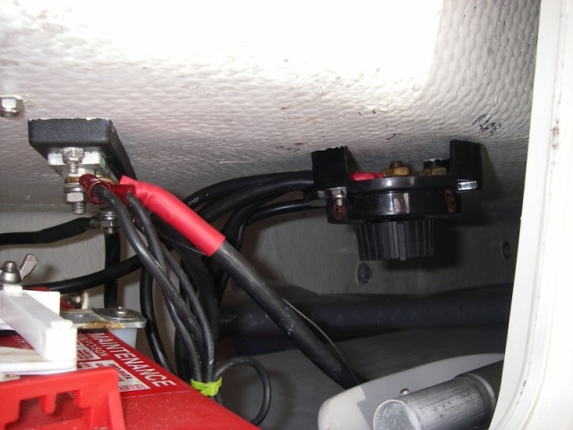

This picture shows how the battery switch and ground bus bar were relocated. Upside down on the bottom of the motor well. I also agree with keeping the grounds tight, and so I use a buss bar.

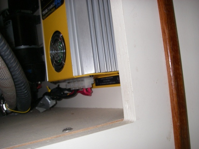

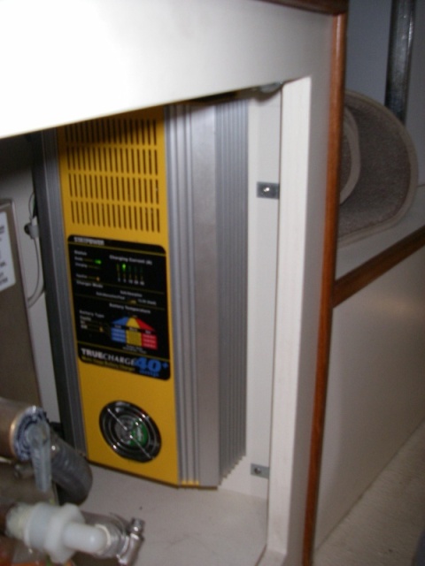

Here is the battery charger. It's hard wired into the main panel, in place of the factory battery charger, in the water heater cabinet. Put vents in the door to vent heat, and no problems yet. This is a Xantrex 3 stage, 40 amp total, but any good marine charger could be used. Any charger which comes with alligator clips or is a plug in type is not what I would use.

PostPosted: Sun Dec 30, 2007 7:19 pm    Post subject: Reply with quote
Well, I'm not sure where you only got two positive leads to each battery. I should have used a terminal strip for each battery (but I didn't, and neither did the factory.) However, here's the best I can do:
Battery 1 (golf cart)
a positive wire at least to the following:
1. main battery switch (the one above the battery, which the factory installed and I moved.) This switches power from the engine and to the main DC panel between battery 1 & 2.
2. Inverter switch ( the two red cables above the backup battery lead to the inverter switch, so I can remove power from it.)
3. DC voltmeter, one for each battery.
4. Battery charger, one to each battery.
5. Wallas stove
6. Forward bilge pump.
Battery 2 (backup.)
As battery 1, except no inverter or Wallas, and aft bilge pump.
There is a single ground wire to each battery, (I hope and pray.)
