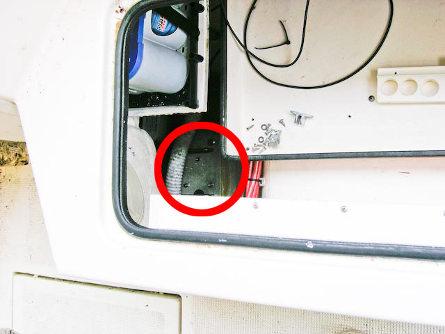

I had such bad luck with the transom transducer on my previous boat that I was insistent on a shoot-through transducer for the TC (there is a core-free spot molded into one sponson for this purpose.) I absolutely love this transducer. However, I am adding a dedicated speed paddle wheel & temp module so I can measure current and water temp.

Warren, did you have to move the bilge pump in that port sponson to install the transducer? Do you have a pix of it?

I don't have a picture, but nothing needed to be moved as far as I know. The factory leaves a space there for people who want to use this kind of transducer. I'm going over to the boat today so I will see if I can get a picture.

It's an Airmar M260 transducer and was recommended by Jeff Mesemer when he was with C-Dory. They are pretty expensive, but I got mine "free" as part of my negotiated off-season deal for the boat.

Here is a photo of the transducer. It is located aft in the starboard sponson.
Sorry for the poor quality photo. My flash did not work (probably because the battery was low) so the photo was taken using a high ISO and I still had to tweak it to bring out the shadow detail.)
