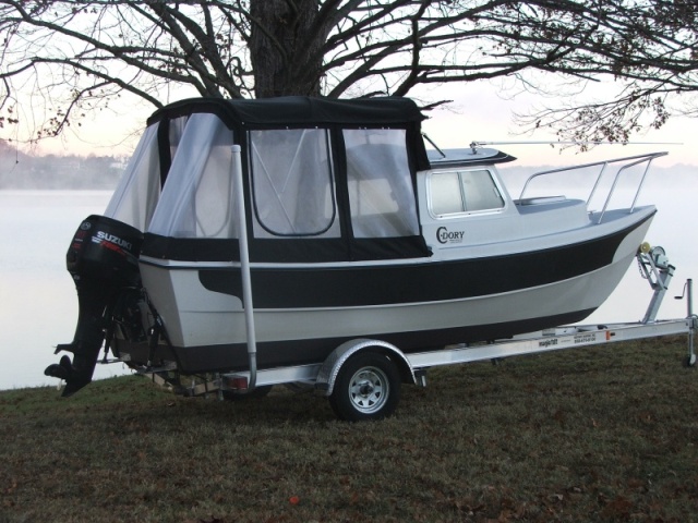

Byrdmans 18 with a 50 Suzuki
it works well
