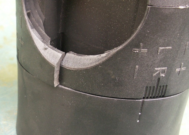

Here's a pic of the break. Actually it broke in all three places where the blades broke. Anybody care to hazard a guess as to what is going on here?

Pat, My guess is, plastic parts vs 150 hp and rocks! Horsepower and rocks win Embarrased Besides, Stainless is much more macho CoolSmile

Got a new aluminum 15.5 x 15 x 3 prop on order, sorry! SS is great but just too expensive! Not sure whether this is the right decision, but the die is cast! Stay tuned!

Not sure what broke it, but if you periodically hit rocks, then by all means go aluminum. Whatever broke it, the aluminum will be stronger, and hopefully will not tear up so bad that you cannot limp home. However, a Stainless prop is so strong that much of any impact energy would be transferred to the splines and prop shaft..or worse. Better a prop then your lower unit.
It's all that PNW sunshine. Is the boat stored outside with the prop in the open when on the trailer? Maybe some UV degradation taking place? (I can't believe I beat Joe to this one.)
PostPosted: Thu Jun 28, 2007 12:00 am    Post subject: Reply with quote
So, you are basically saying the rain made it fall apart? I can TOTALLY buy that...it is making ME fall apart!

Pat, I was serious with the UV question. Here's just one line quoted from an online reference I used:
UV energy absorbed by plastics can excite photons, which then create free radicals.
Seen many radicals wandering around? Maybe your prop was sabotaged and this is a Homeland Security matter.
Where is Joe?? I know DoD is sometimes slow with his erudition, but I am worried about the professor.
PostPosted: Thu Jun 28, 2007 8:24 am    Post subject: Reply with quote
(A) I don't believe we hit a rock, did not feel a darn thing when it went...
(2) No cracks about us radicals, please!

Pat, you have my sympathy. I broke the plastic prop in the middle of 'Dent rapids.
I now have an Apollo stainless steel prop, 4 blade by 16 pitch. Its imported by Michigan Wheel. a dealer balanced it for me under warranty, and we're using it on the Great Lakes this summer. So far its pretty good. It was ~$200, on the internet. Another $25 for a spare shear fitting.
I think the plastic is just too brittle, cause we hit something small and it took out 3 blades. that's unacceptable, dangerous and downright scary.

Thanks for the picture Pat. The reason I ask is that My propulse broke the hub in the same place this last weekend (40 miles of shore) so I had to do an on the water prop change back to the aluminum prop.
I have never hit anything with my prop so am thinking this is a problem with the Propulse design. I ordered a new hub will be interesting to see if the design has changed.
If the propulse did not perform so much better than the aluminum prop I would have some reservations about going back to it. I do have to say that the Propulse has been problem free for over 4 years and I was never able to go a year without damaging the aluminum prop and spending 50 to 75 bucks to have repaired.
