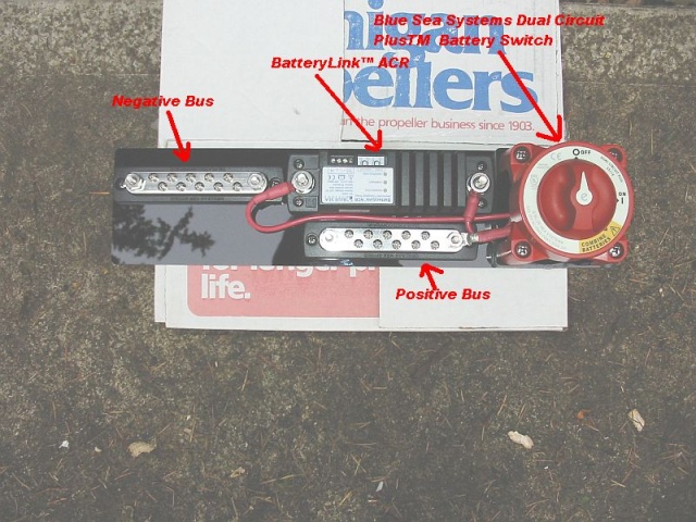

PostPosted: Wed Feb 07, 2007 6:45 pm    Post subject: Reply with quote
It's pretty small, too. One odd thing was some webbing that prevented
me from running wires out one side. However, I was able to cut
out the plastic pretty easily. Supposed to glow in the dark, too! I
haven't really checked though since we have a security light near the
boat.
