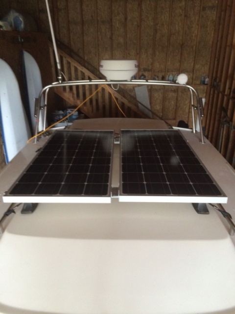

I’m leaning towards returning the flex panel and keeping the 100w regular size panel. I have rotor rails so I think the best option will be running the panel across the roof suspended on supports that are mounted to the grab rail. I can put some cutout PVC blocks midway to provide additional support and vibration dampening.

I had a couple of flexible solar panels on a yurt for years. They got blown around, pitch on them, and mistreated. Still worked fine when I gave them away. I was impressed.
I put a flexible solar panel on the Limpet using SNADs. It is a small panel and is attached with only 4 SNADs. No drilling through the cabin top. By putting a stick-on rubber furniture pad on the back of the panel, it is held away from the deck, creating an air space and avoiding the problem of flexible panels overheating from lying directly on the deck. I was concerned about whether the SNADs would hold in a stiff wind, but have had no problems on the freeway. Good for sustained 70 mph wind.

Current plan Is to mount the single panel on the roof using vibration-dampening bolt-on feet secured with Velcro to the roof, with shock cord running to each grab rail and to the radar arch.
I don’t intend to tow with the panel mounted in this position.
