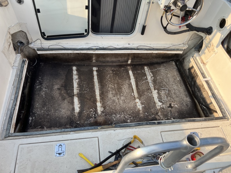

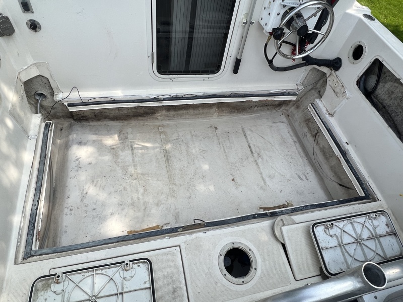

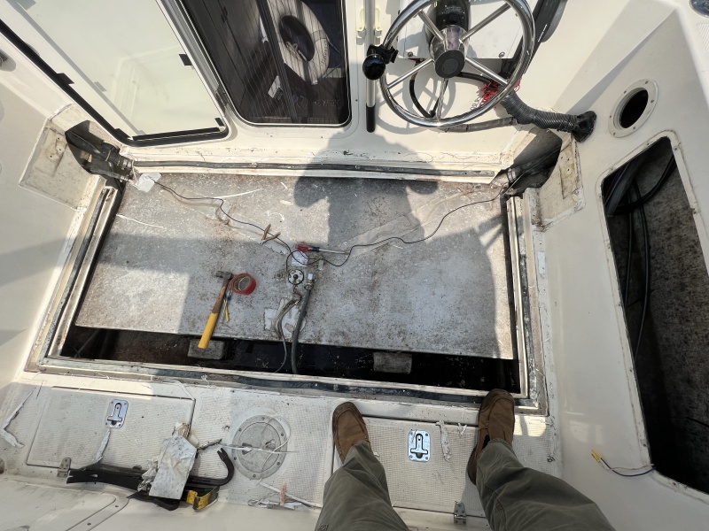

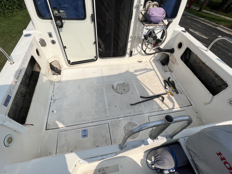

This photo is of the cockpit with the steps removed. To remove them I went in through the small access plate to remove the screws holding a metal bracket between the steps and sidewall. I also removed the side boxes to have better access.
To remove the cockpit floor, I used a utility knife to cut through the sealant (I used 4000 UV last time I had the floor up). Then used pry bars to help leverage breaking the cockpit floor free. If you look directly behind the fuel tank, there are two blocks that are fiberglassed to the hull to keep the tank from sliding backwards. The tank is pushed up against the cabin bulkhead. These blocks must be removed so you can slide the tank back, and then slide the tank to one side or the other, so it will clear the side of the floor opening. I was able to chisel the bottom of the blocks free from the hull. The real pain was getting the fuel fill and vent hoses off. I removed those first. I am replacing with new hoses. The vent hose is 5/8" and pretty easy to find. The fill hose is 2", and not so easy to find. Great Lakes Skipper has both, and my total bill for all four hoses is just over $100 with shipping. The 2" hose was 27" long on each side, and the 5/8" was 24". This photo is with the cockpit floor removed.

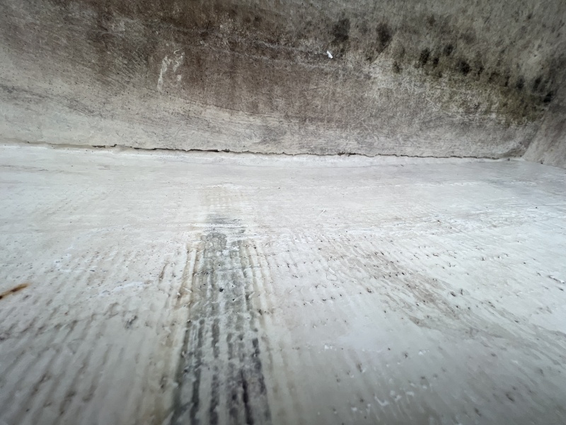

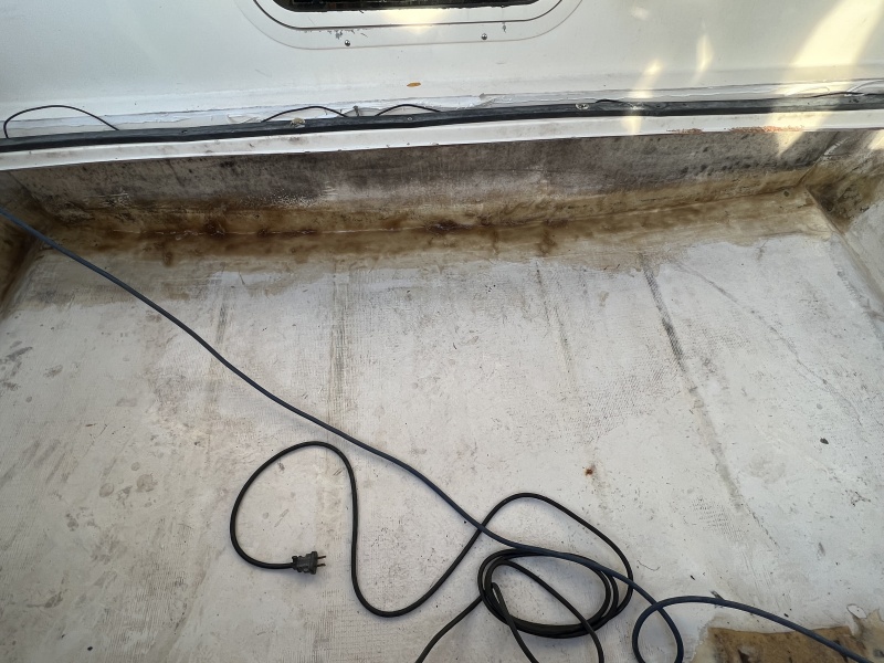

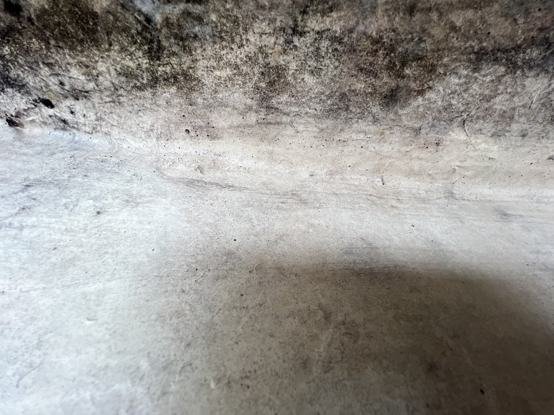

Once I removed the fuel tank, you can see the mold/mildew along the bottom of the bilge. The white strips are where the fuel tank has spacers taped to the bottom of it.

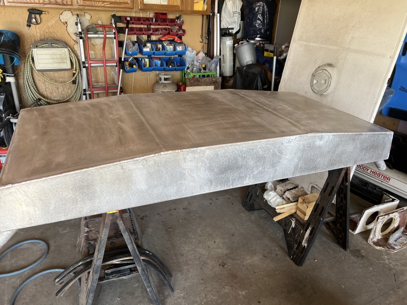

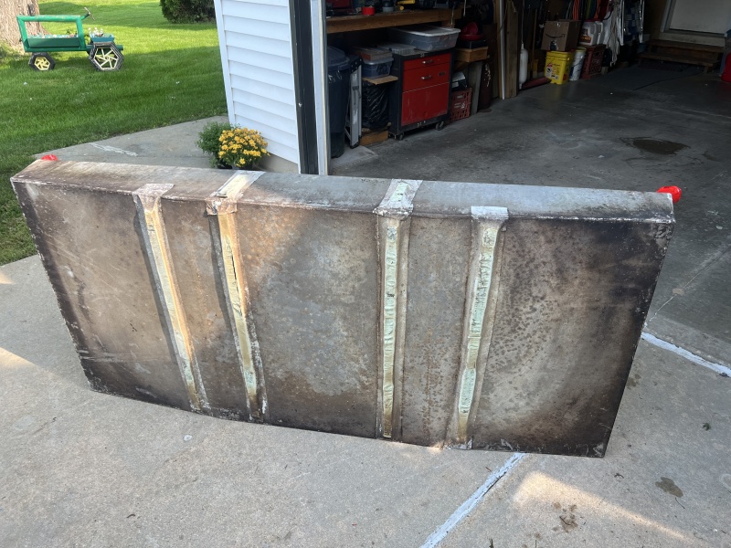

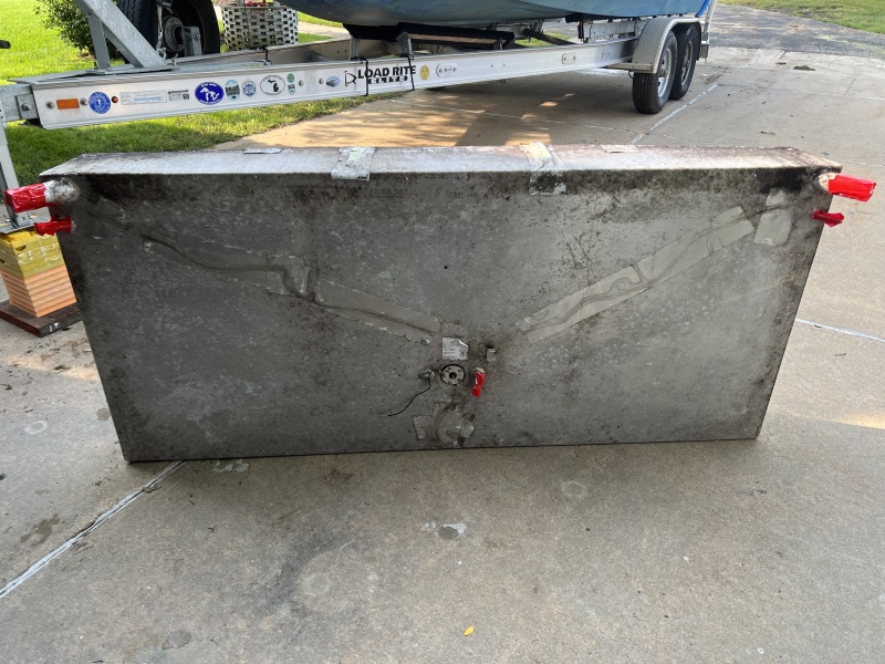

The fuel tank is now out, and sitting up on edge. I pressure washed the top of it a few years ago when I pulled the cockpit floor. But still some new grime.

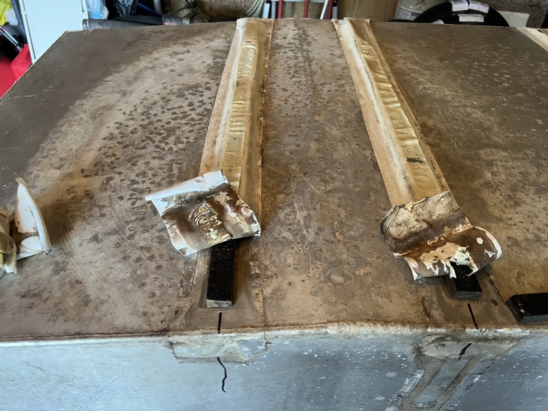

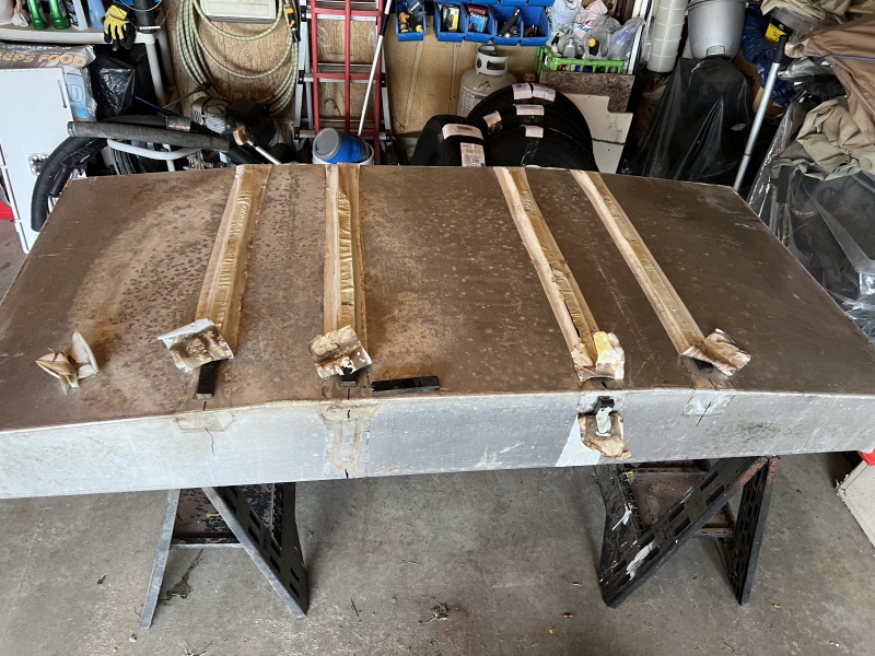

The bottom of the tank (before pressure washing) has spacers taped to it so it does not sit directly on the hull/bilge floor. There are also some spacers along the front edge so it doesn't sit flush against the cabin bulkhead. You can also see the pitting along the tanks bottom in this photo.

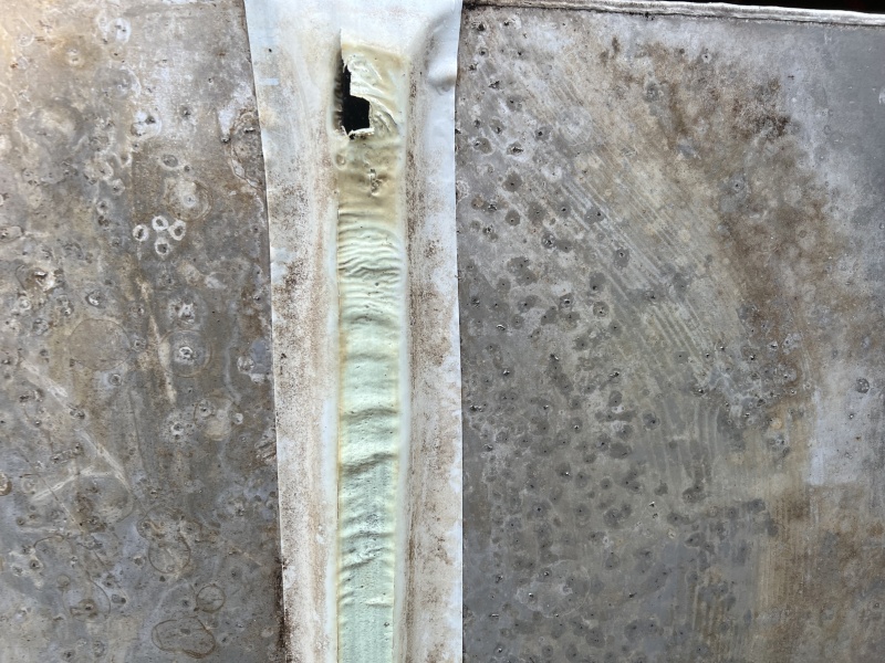

Here's a close up of the tank bottom. Better view of the pitting.

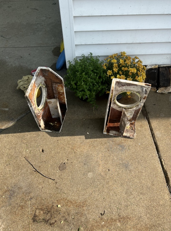

Here are the steps. You can see that there is core rot along the edge. I repaired these half ass last time I had them off, with the use of spray foam and some fiberglass. This time I'll take time to grind them out better, place some new wood in place, and then a better job of fiberglassing.
Bilge pressure washed, all nice and clean.
Some closeups of the area that appeared to be leaking into the cabin.
Hard to see in this one unless you can zoom in, but there is a small hairline crack along the base of the bulkhead.
Fiberglass matting and resin used along bulkhead to hull area to repair leak. I filled the bilge with about 3" of water. All good now, no leak!

Both a good and big job, Colby! There have been a number of the 25's which have leaking from under the aft cabin bulkhead, I am aware of several with some core rot in the lower part of that bulkhead. The only thing I would have done different would have been to use fiberglass tape and epoxy, mainly because this gives a better secondary bond. The boats all should have had mat, tape (cloth) mat/tape done before the gas tank was put in. Some do. All should have the mat/ tape on the cabin side. (I suspect that some don't all of the way around the hull part of this bulkhead,
If the boats have gotten salt water in the bilge, then they are likely to have pitting of the tank...It is good to see that the tank was properly elevated on strips of ???. It should be a plastic or fiberglass. It should never be a material which contains carbon (ie any "rubber" compound). Unfortunately the tanks were not made with a corrosion resistant aluminum alloy.
At this point (I assume the fuel tank is empty and had been purged of any gasoline.). The strips of material on the under side should be removed, and then the entire tank cleaned on the outside. Ideally it should be totally bright and all oxides removed. This is where there may be an issue with the depth of pitting. Ideally the pits should all also be clean of any oxide. I would start with sandpaper by hand to get a feel for what is going on. If you are really lucky, the sandpaper will be enough... However a wire brush may be necessary. If the pits are deep--then a new tank. I am surprised at the relatively few numbers of new tanks which have been fitted.
After the tank is bright, you need to clean with either denatured alcohol or acetone, and then etch it. Then coat with a two part epoxy.
See this edition of Epoxyworks. Do not be tempted to use polyester or vinyl ester resins. They will not have the adhesive properties required.
After all of this is done and dry, I would put strips under the tanks as before, and adhere them with 5200. I would coat the entire tank. With some luck the tank will last for many years.
However, if there was corrosion inside the tank, then I probably would considering a new tank. You may still get away with many years of the epoxy coating on the outside. With the boats which have the removable floor, I would take a chance. With the boats where the floor has to be cut out (earlier than 2004 ?) then I would go with the new tank.

I strongly suggest that you do NOT use polyester resin and mat on the bottom of the tank. The epoxy will adhere much better and increase the longevity of the tank. . Do not skip any of the cleaning steps. There is a very good reason that is what is recommended.
It is also important to put the spacers under the fuel tank--I don't know what was used in your boat, but if you have to use your mat and resin, then you can make some new battens to go under the tank. I suspect that the old were fiberglass with polyester resin.

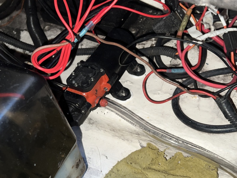

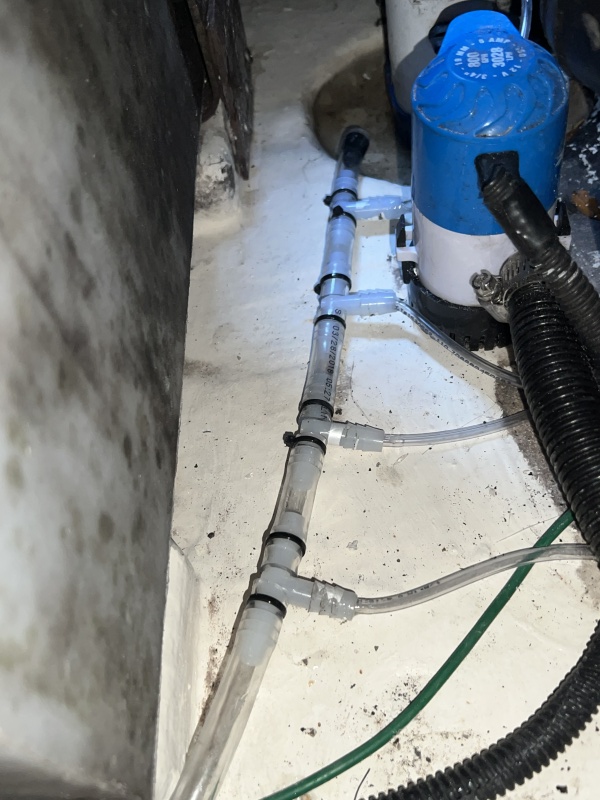

Time for an update. I've been working on not just the fuel tank, but a bilge sucker system as well. I finished installing my bilge sucker today, and got the tank sanded. I used a 6" pneumatic orbital sander first with 40 grit sandpaper, then finished with 60 grit. I did hand sand around the edges. Sanded the bottom and all four sides of the tank. I did lightly sand the top of the tank, mostly just to remove some dirt and a little bit of corrosion. (Just the white dust...) I then wiped the tank down with Acetone. I will wipe it down one more time just before putting the G/Flex epoxy on. That should arrive tomorrow, and I'll likely do that job on Wednesday. I did pull the fuel gauge sender unit, and looked into the tank. Can't see much through a 2" hole, but what I did see, the insides of the tank looked fine. I plan to put the epoxy on the bottom and all four sides, but leave the top alone.
There was pitting and corrosion under where the spacer strips were taped on. I'm sure the tape trapped some water, and I'm pretty sure the spacers are some form of rubber. I don't understand if rubber causes corrosion with the aluminum, why the fuel hoses don't create a problem?
I will likely reuse the spacer strips, since I will have epoxy on the tank when I put them back on. I'll also use the 4000 UV to adhere them on.

These first two photos show the spacer strips a little better. The tape left quite a bit of residue.
Fuel tank is sanded and wiped down with acetone, ready for the epoxy. I'll be using the G/Flex 650.

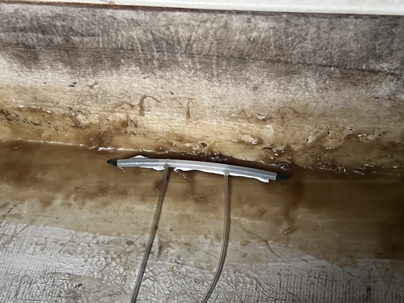

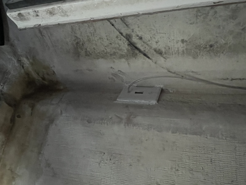

This is one of my bilge sucker pickups. I used some old switch plates and tacked some 3M Green pads under them. Then glued in some 1/8" ID tubing. I placed one each in each chine towards the front of the bilge. Then I used some 1/4" hard plastic tubing to make a sucker for the front of the bilge. I just placed a small cut off of the scotch pad in each end of the straw to act as a strainer. Again gluing the 1/8" tubing into it. The tubing then runs back to the manifold, made out of 3/8" tubing. That attaches to the pump, which is mounted in the back compartment in front of my battery tray and electrical panel. I wired it in with a secondary / backup bilge pump I installed previously. The discharge hose runs out into the splash well with all the engine wiring and hoses. (The suckers are tacked in with 4000UV)
Posts: 3625
PostPosted: Tue Sep 20, 2022 1:16 pm    Post subject: Reply with quote
On your bilge sucker setup, how do you clean the strainer? It seems to me that the crap that typically accumulates in a bilge will clog them up sooner or later.

I have no way to clean the scotch pads I used other than to reverse flow. I suspect over time they will become clogged and useless. But this is the part of the bilge where water collects and no room for a bilge pump due to the fuel tank. It’s basically an inaccessible area once the fuel tank is back in. Once they no longer work it’s back to just putting my weight in the stern and running the regular pumps.
Are the bottom of the pits shinny and corrosion free?
Hi Bob, Unfortunately, I'm not sure. Without grinding the aluminum down to the depth of the pits, I don't think there is anyway to get to the bottom of them, other than perhaps reaming them out. I'm not sure that would be a good idea. I did use a tire depth gauge on the wider pits, and it showed less than 1/32".
The fuel hose isn't in the water. I thought maybe it was the rubber compound that caused the corrosion. Guess I'm not understanding that very well. Colby
Posts: 21604
PostPosted: Tue Sep 20, 2022 7:08 pm    Post subject: Reply with quote
There are micrometers which will measure the depth accurately. If close to 1/32, I would be concerned.
Fine wire brush will get into these pits and make them clean enough to assure good bonding with the G Flex. You are not really removing any aluminum, just the oxide on the surface with the fine wire brush.
The rubber has to be in direct contact with the aluminum, and the carbon in the rubber (or any compound) is what is the conductor to cause the damage to the aluminum. If your spacers are containing rubber / carbon then there is a chance that you will have problems under the strips. This comes primarily from David Pasco, but is repeated by many knowledgable boat builders. Often graphite is added to materials to make them black. It is a complicated issue, for example with neoprene, does it contain carbon or not. Pure neoprene should not..but.
