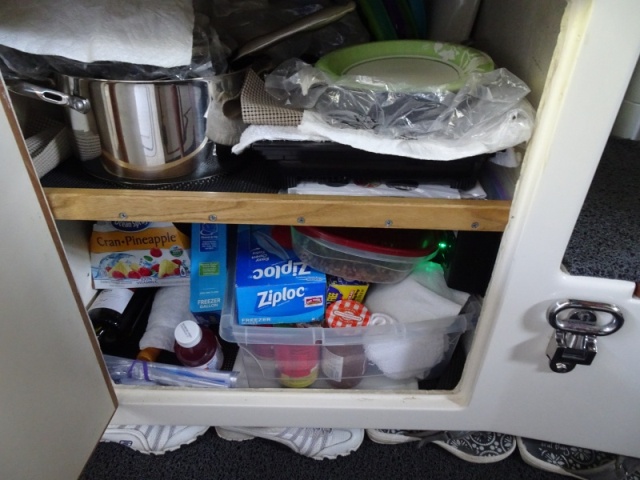

We have a shelf about half way up. We store all items in shallow plastic totes. There is an assortment of sizes to get all in place. As we need items.
Under the sink:

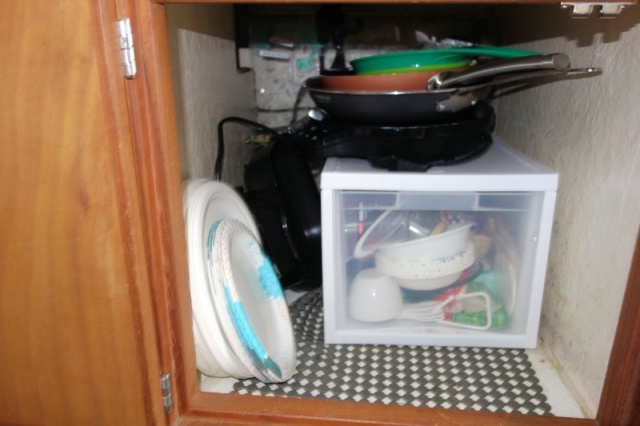

We use one of those plastic drawers.

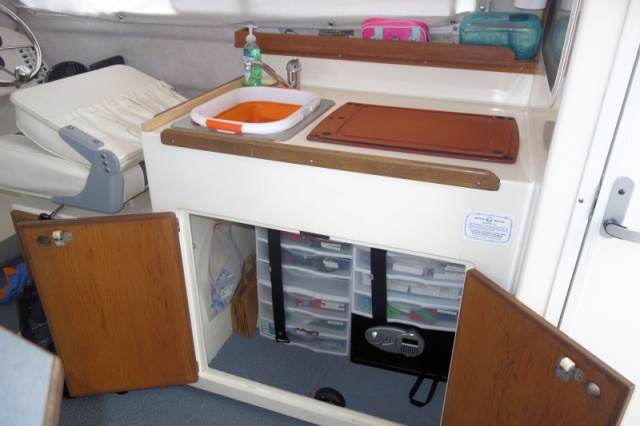

Like others posting, we use Walmart plastic cabinets under the sink. We add straps bolted into the frame at the bottom and industrial strength Velcro patch (bolted into the top). They don’t slide around on the Dekadence carpet. The safe is SS cable secured around the rigging conduit. We keep pilfer items in there (like the $900 Fuji Stabi binocs, Steiner Marine binocs, 3 of 5 HH VHF radios, passports etc and most of the loaded weapons). We don’t lock the aft door, since it could be pried open with a large screwdriver and one Brat here related it was $10,000 to replace it.

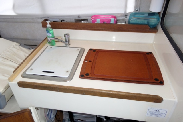

We didn’t like the butane stove that came with our boat, so I removed it and found some same-size clear drop in plastic bins at a restaurant supply store that hold condiments etc, which are covered by thin cutting boards.
https://www.epicureancs.com/product/all-in-one-boards/
The white cutting board sink cover has bolts at four corners so it can’t slide off underway.
The collapsible basin fits in the sink perfectly; Eileen bought and uses two when cruising. The two are under 4 inches high when collapsed. The round black magnetic LED AA light turns on and off with a touch.

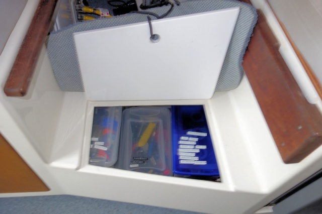

We also used clear plastic Walmart shoe boxes with lids (for stacking) for storage under the table and under the Nav foot rest.
