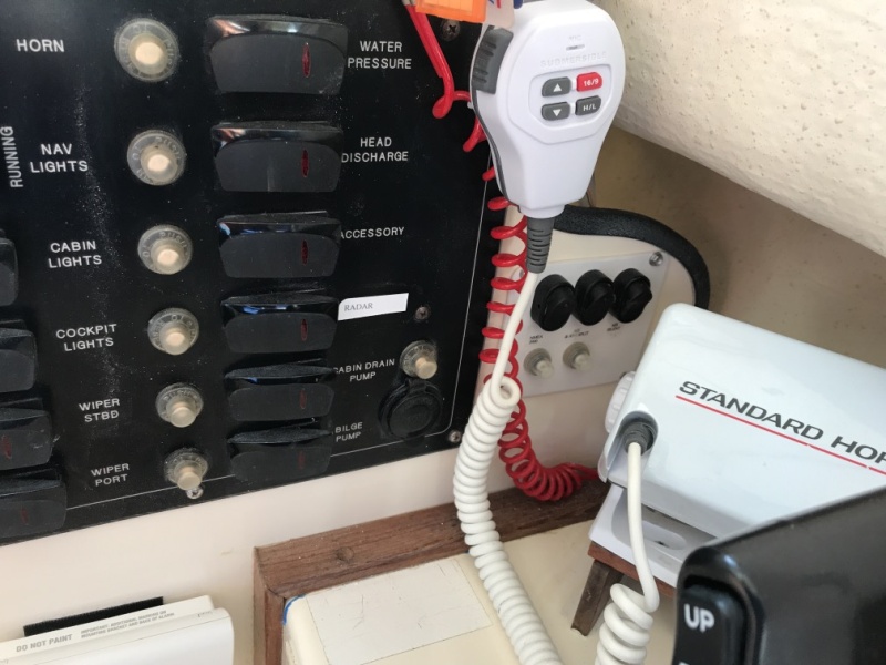

Hi all -
I am looking at putting in a radar (1st Watch Wireless) and am trying to figure out how to add a switch so that I can turn it "on/off" from the panel at the steering area. SPST I suppose.
The front "rocker" switches next to the steering column are full, and so is the fusebox (12 fuses). But one of the fuses is for a cigarette lighter that I don't really need. Just not sure how to buy an on/off switch with indicator light (when "on") that I can mount next to my steering wheel near the trim tab indicator? Or can/should I just get a switch with a breaker (at 5AMP?) and not worry about the fuse box or cig lighter at all? (Really - does that even exist - in which case I would just pull +/- line?) Radar in-line fuse is 5A for radar, so I assume fuse / breaker would be 5A as well?
And to mount a new switch, what is the best way to cut into the cowling? Or, should I just replace the cig lighter with a push button on/off which might be simple as there is a hole already there, and wired already to fuse box with a 5A already in place...
Thanks for any thoughts/advice...
K

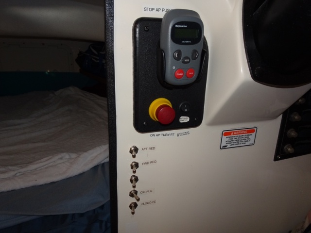

Here is a photo of the extra panel I added to our last 22:
Here are the 5 toggle switches just thru the fiberglass 1/4" thick

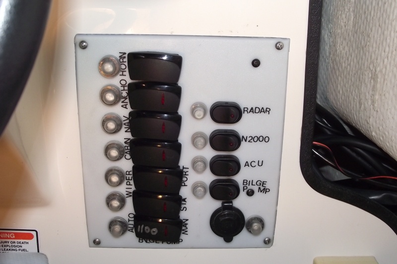

After removing some items in my 25, I had several switches left over. However, before that, I had installed some other electronics that I wanted switched, so added some cbs and switches just to the right of the main panel. I actually put in a whole new switch panel in Midnight Flyer. But here's one photo of C-Traveler for an idea.
Here is a photo of Midnight Flyer with the new switch panel. I used some starboard or like material that I planed down to 1/4" or so.
[img]
In any case, you can get the circuit breakers in the photos from Amazon or any marine outlet. The smaller switches I used, which do have indicator lights in them, were from radio shack: m/n 275-018 cat/n 2750018. [/img]

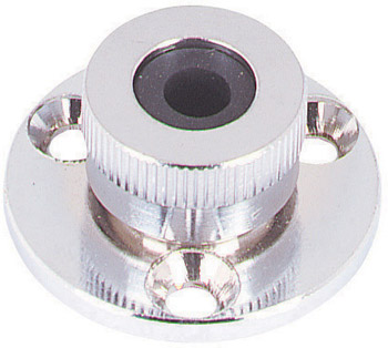

I like to use "Cable Clams" . They will allow you to use a plug, like on a transducer cable, thru the hull, and yet have a tight seal on the cable.
Shakespeare makes theses glands:
