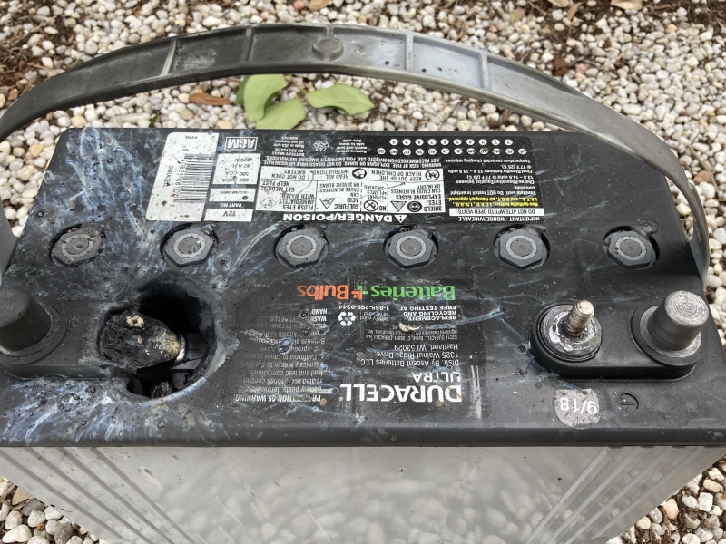

I was in the boat on the trailer in the yard updating my chart plotter software, and as I was buttoning everything up I glanced at the Pro sport 20 onboard charger. It was showing a fault in battery 1, I went to the battery selector switch and really without thinking decided to switch it to battery 2, when I did this I heard buzzing from the battery compartment and was unable to pass the switch through the "all" selector to 2, it was stuck on ALL. I backed up and proceeded to watch battery 1 spark, smoke and almost catch fire, quickly I went back to the switch and turned it off, then unplugged the power cord to the boat and grabbed the fire extinguisher, watching this happen next to 10gal of gasoline wasn't very fun.
I unhooked and removed the batteries, battery 1 now has a large golfball sized hole in the top at the positive terminal and battery 2 has a little melting also at the positive post. I used the boat last week no problems. My initial thought was that battery one for some reason was discharged and when I went to "all" battery 2 violently discharged into battery 1 causing the fire. However when I measured the voltage after I removed the batteries, battery 1 was at 12.7v and battery 2 was at 12.6v. Both are about 2 years old, duracell 92ah AGM's. I leave them on the pro charger when not in use, the boat sits in the yard in the trailer when not in use.

PostPosted: Sat Sep 19, 2020 8:33 pm    Post subject: Pic Reply with quote

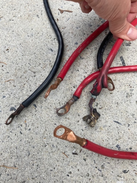

PostPosted: Sun Sep 20, 2020 2:01 pm    Post subject: Cables Reply with quote
Here are the cables. I'm pretty confident it was a lose connection at battery 1 and battery 2's positive terminal, more so at battery 1. Both of these terminals had wing nuts on them which I should have changed out to nuts with lock washers and properly torqued them. The loose connection generated heat when the batteries tried to equalize. Both in Calder's book ( gave this specific example of a loose battery post nut which lead to fire) and the guy at the battery shop validate this theory. The guy at the battery shop said they see this a good bit with golf carts as the connections rattle loose then gets hot 2/2 high resistance and it melts the battery top. I don't believe the charger was over charging because it was showing a fault with battery 1, probably 2/2 the loose connection. Had I turned the selector to off instead of going through "all" in order to get to battery 2 and then checked the connection I could have prevented this.
I'm replacing the selector switch with a BlueSea version and replacing all of the battery cables as well as two new batteries. The rings on the cables at the battery were ⅜ while the battery studs were 5/16. I'm going to size all of this properly and start new.
You can see in the picture that the wing nut is still on the terminal which melted.

PostPosted: Sun Sep 20, 2020 2:33 pm    Post subject: Cable Reply with quote
I carefully inspected the cables, I did not see any visible corrosion. It appears that the highest amount of heat was at the battery terminal itself.
