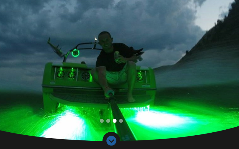

The boat plug light makes me a little nervous - at least the way its presented on the company web site (not sure how you plan to use it). They say, "Light up your wake," and show boats underway with their wakes lit up in green, red, blue, etc.
Seems like (especially) a green or red lit up stern wake would conflict with navigation lights (white only to the stern; red to port; green to starboard).

Just to clarify, I wasn't thinking specifically of you (you probably wouldn't use any of them underway), but just musing that it seems like a poor product marketing/choice by the company. Mostly because they encourage a buyer to "light up your wake," and show many boats doing just that (vs. using them at a dock or something), and with red/green lights to boot.
Actually though, now I'm curious: What do they have you putting in place of your plug? I hope it's sturdy and not just a light bulb! (It must be...)

You bring up a good point. Our water way has a large house boat that charters as a party boat and has bright red and green lights (possibly lasers) flashing on a large disco type ball that reflects the lights in all directions. Can you imagine the confusion one experiences on a cloudy moonless night when this thing appears on the horizon and you have no way of knowing what course it's on or even how big it is. It just keeps getting closer. Future encounters are a bit scary even when you know what this thing is.
I do think the colors that are associated with navigation should not be made available for other purposes, no matter how beautiful they are when shining through the water and reflecting off all the polished stainless steel.

I see boats all over the Boston Harbor with FULL underwater blue lights that light the water almost 360 degrees around. Yeah, I definitely wouldn't use red or green though. I agree that that seems like a bad idea. I think originally boaters were installing underwater lights for fishing purposes. Now most boats that I see with them are just looking for the "cool" factor. Lol. I'm in that category. I think it'll look awesome!
Yes, it's a sturdy plug. It's hard to tell from the website pictures. When you twist the base it expands/contracts the rubber plug...just like how a T handle works on the normal plugs that we all use. Then on the inside (fuel tank area), there is a quick disconnect to disconnect from the battery wire. Easy peezey.

Here is a photo from the company website. "Light up the wake."
Seems to have it all: Underway on the platform, no (visible) PFD, can of [?beverage] in hand, and green lights astern...

Am I correct that you are not putting the light in the sink drain, but in the aft hull drain?
There have been some jurisdictions (mostly Florida) where citations have been given for any blue lights, because blue is reserved for law enforcement only
I personally don't see the reason for any underwater lights, unless you are attracting fish or bait fish. But there are a lot of things I don't "understand" about the modern world!
