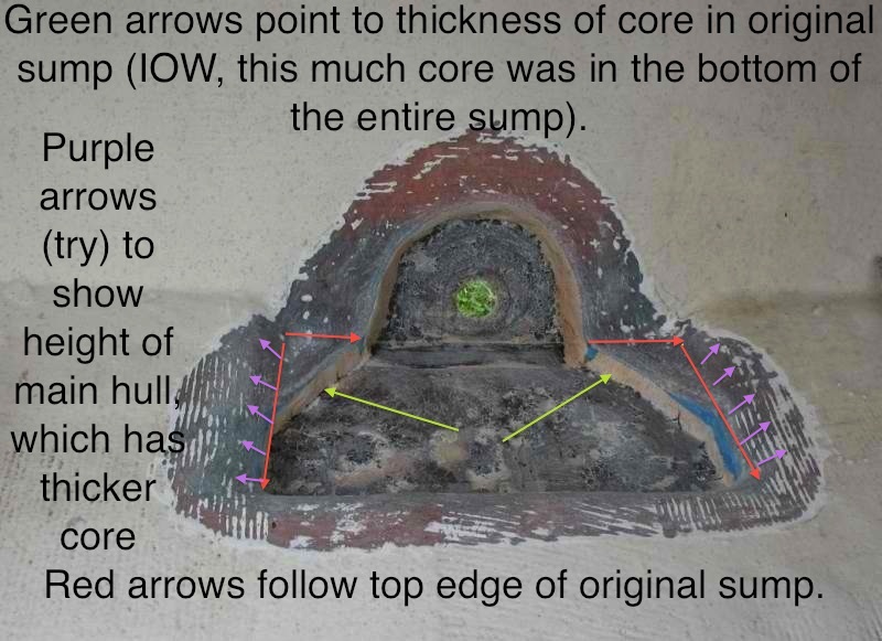

First of all, good on you for taking proactive steps to protect the core. I've done the same on my 22.

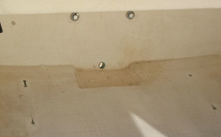

I don't know about the 16, but on my 22 there are two different "sumps" and two different methods of construction.
The sump that is right at the transom IS cored, but just with thinner core than the main hull. I actually dug in and found out (and eliminated it), but you can also tell because the depression is around 5/8" deep, and the hull is thicker than that (over an inch, I'd guess), due to thicker core.
My era 22 also has a sump in the cabin at the after bulkhead, and I'm pretty sure that sump is not cored. It is also much deeper (depth of the hull).
Here is are a couple of photos. Maybe by judging the depth of the sump in question as compared to the main hull thickness, you can decide whether your sump is cored or not.
First, a photo of the sump at the transom that IS cored - you can see how it's relatively shallow.
And here it is "excavated" so you can see the layers.
