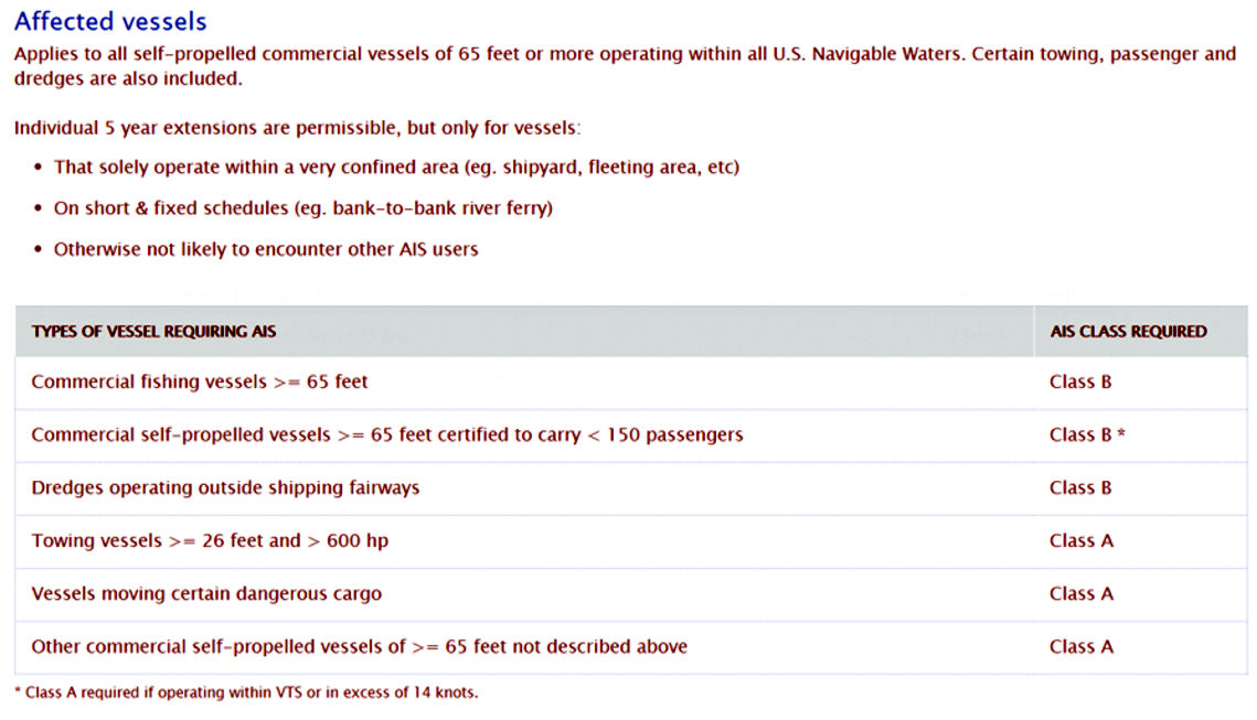

The below are vessels required to have AIS, and there are a large number of coastal vessels (including yachts) which now have the less expensive AIS B transceivers.
[/img]
Considering the amount of fog, and marine traffic in your area, I would especially want the AIS. One of the advantages of AIS, is that it shows you the vessel's speed, direction, size, rudder angle (turning or not) Yes, you can get much of this from MARPA radar, but this adds another layer of safety. Bang for the buck, I think it is a lot.
