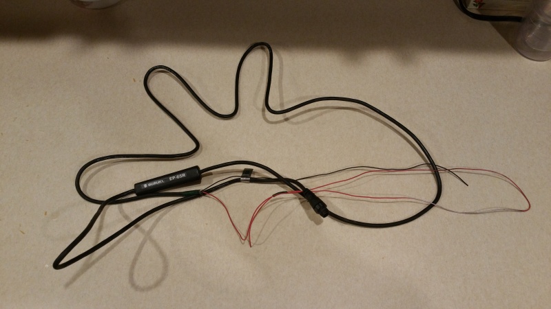

Ok, I dug into the area around the tanks. I disconnected the port (working) EP65R from the tank sender, and it did indeed still present itself on the network, with just an empty tank reading (the tank is completely full). Then, disconnected the starboard EP65R from the tank sender and measured the resistance from the sender. 135 ohms. I've had the boat out twice since the tank was filled, and this is the tank I've been using. One of the trips was a little over 50 miles planing, the other was 15-20 miles of mixed speeds, and some time idling and breaking in the kicker. Over halfway full per your ohm figures Bob, so this is about exactly what I'd expect. I'm really glad, because there is literally ~3 inches of clearance above the tanks. Replacing a tank sender would require removing the tank. I had all I could do to get to the location where the wires attach to the sender, with my shoulder buried in between the gas tanks and my forearm crammed between the tank and the underside of the motor well. I came out of it with some nice scrapes and cuts on my arm.
But, I was able to get the alleged offending part removed:
I was able to put everything back together including the wire connections at the tank, so installing the new EP65R will be a lot easier than it was to figure out how to remove the old one. I'm placing and order for a new unit, and will post final results after I finish the job.

Thanks Bob - yeah, there were already leads in place from the tank sender, with crimp connectors buried up under the starboard gunwale in the wiring harness, inside some wire loom. I had to remove the leads and trace the lines to learn this, but now I know where the connection points are, so installing the new unit will be less than a 20 minute job to have everything back in place. Just a little routing of the wires, two wires to crimp, and some new zip ties.
Also I will add, I played around with the supposed defective unit after I got it out, plugging it into the different ports on the NMEA bus, and I tried it with the sender leads disconnected, and also with them shorted together, and I could not get it to show up in the bus device list with anything I tried. It's almost certainly defective. I don't see anything at all wrong with it visually. All the wiring looks to be in good condition, and no sign of cracks, water intrusion, etc. on the inline units.
