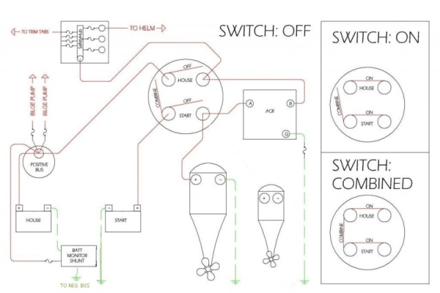

Side benefit: As a result of posting some drawings of my system here I did change a few (unrelated to problem) things to improve my wiring setup. I will still be using a main fuse, since that's the way my boat is set up (Blue Sea Safety Hub), but I increased the helm feed wire to #6, and so was also able to increase the size of the fuse protecting that wire (not sure whether or not that would have helped on Powell, but the system is improved at any rate). I have more spare fuses now too Very Happy
I had a pro do mine originally, but even then I found some areas that could be improved, and have been making those changes. It really helped to draw out the whole system*.
*Thanks to AK Angler for making the drawings

I don't have fuses on the two "main" ACR cables (I do have the specified fuse in the ground wire). I don't think I've done anything horribly wrong, but I'm re-evaluating all of my overcurrent protection, because I have the feeling it could be improved upon (I think I don't need to use the ABYC starting circuits exception - that I think I am using - but could instead benefit from battery fusing; but this needs some study on my part). I will be interested to see what you find out on this. Here is a diagram that mostly shows how I have things now.
One thing I suspect is that, well, you know how it seems like "Gee, I'm putting this ACR in and now suddenly I need all this extra stuff!" My guess is that for many of us, we could have used some "extra stuff" (in the way of overcurrent protection, better wiring, etc.) all along, but it just shows up as a part of changing things because you step back and take a look at the system. At least I know my 22 didn't come with a truly "proper" electrical system. So I mean even if I had stuck with the same type of switch it originally had, I really could have stood to change things to make it better/safer.
