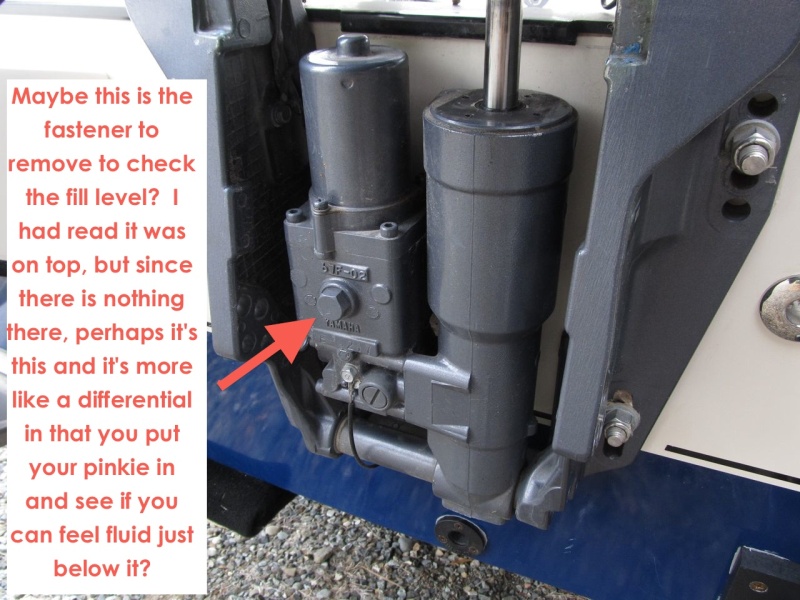

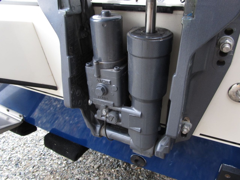

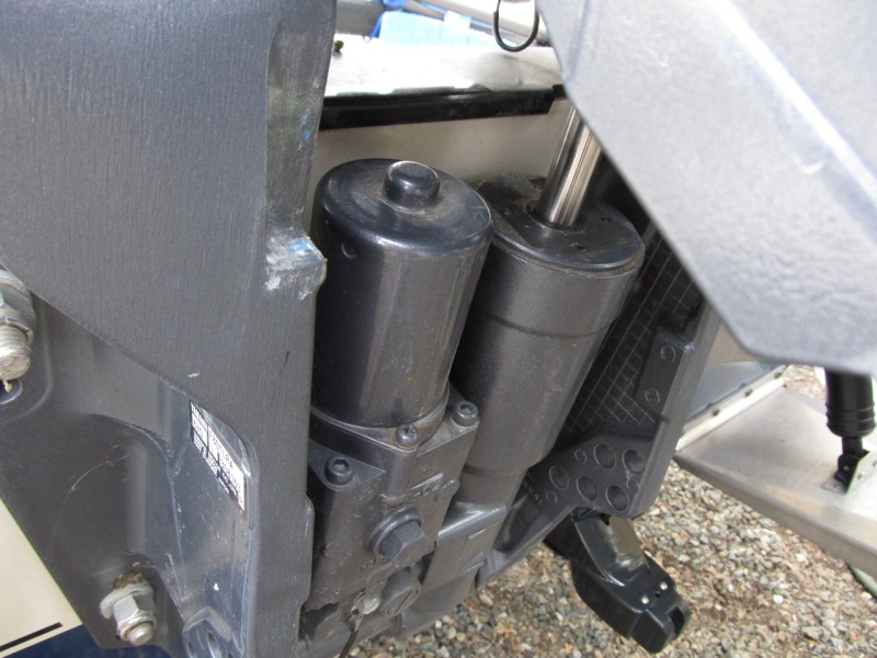

Well now I just have to find the reservoir -- can you tell I'm a complete novice at this?
(I've never had anything larger than a 9.9...)
I'll take a photo and post it, and maybe someone can point it out to me (or maybe it will be obvious with another look-see).
Edited to add: Here is the trim/tilt area. It's not obvious to me where to check the fluid level (and/or add fluid). If anyone can tell me, I'd appreciate it.

The 14mm(I think) nut below the Mtr. is the fill/check for the system. The slotted plug below the fill plug has a check valve in it that probably has a paint chip stuck in it causing the ram to bleed off. There is another check valve on the opposite/inside of the pump. Wink Mr. Green Beer
PostPosted: Sun Aug 25, 2013 10:01 pm    Post subject: Reply with quote
I was just going to post this annotated photo, guessing that protruding nut was the fill. Nice of you to confirm it. And interesting about the check valve screw - will look at that more closely.
