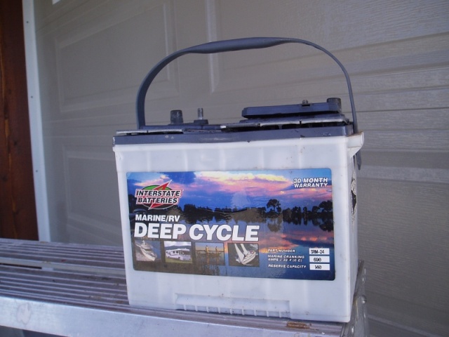

PostPosted: Mon Mar 18, 2013 5:02 pm    Post subject: Reply with quote
This picture shows how the battery looks.
I guess seeing it has been 84 months since installation date I shouldn't expect any warranty! LOL.
I think what probably happened is I've gotten fairly lax in checking the electrolyte level because in the past 7 years the batteries have hardly needed any top ups at all. This batteries mate, the one that isn't damaged is quite low on electrolyte. I'll bet I let them get too low and that is what caused the problems.
