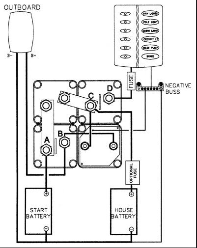

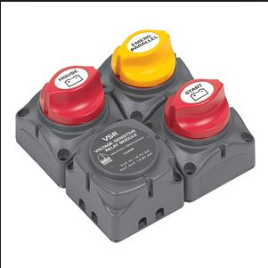

This is what I used in Voyager and it works very well.
Here's the wiring diagram for it. This is what Dr. Bob was talking about.
There are other brands out there that would probably work too.

Since it came up in this thread, I just thought I would mention that I have re-wired my ACR so as to avoid the small parasitic load normally associated with it. Now, as we have determined previously, I'm no electrical expert, so I'll just explain what I did:
So, I found out and confirmed that the Blue Sea ACR draws a small (very small) load even when it's "off" when wired in the usual (?) way. The first suggestion I got was to put a small switch in the black wire that comes out the bottom of the ACR, then switch that off if I was going to be leaving the boat in storage and wanted the small load deactivated.
Well okay, but.... that just didn't thrill me. I mean, the system design is supposed to be sort of "hands off" except for turning the battery switch on and off (I have an "On-Off-Combine" from Blue Sea), so to add some other little switch that I have to mount, keep from accidentally getting bumped, and then remember when it's only an occasional thing, so not in motor memory.... well, I could just see it leading to one of those "Did I leave the iron on?!" sorts of scenarios. Or, more likely, it would go on a check list, but would annoy me every time.
I also wasn't sure exactly what type of switch, so I called Blue Sea. The tech fellow (very reasonably) stepped back a level and asked me what I was trying to accomplish. I explained. He agreed with my mission and listed three ways to accomplish it:
1) A small switch in the black wire coming out the bottom of the ACR, to be left on most of the time and switched off when I wanted to be sure there was no parasitic load from the ACR.
2) Re-wire the ACR so that it is switched off whenever I turn my main battery switch to "Off" (thus no parasitic load).
3) Wire in a solenoid so that the ACR is de-activated when I turn my ignition switch off.
Well, #2 sounded perfect to me. Simple and automatic, like I thought it would be in the first place (I don't mind manual systems at all - in fact I usually prefer them - but I really didn't want a hybrid). When I was on the phone with Blue Sea I didn't have exact information on how my system was wired up, so he didn't give me the precise way to rearrange the cables, just the concept. So I later called the person who helped me to set up the system (apparently there is more than one way to properly wire in the ACR) and he had me check a couple of things and get back to him, and then what I did was this:
a) Remove short jumper cable that ran from the Safety Hub to the ACR right side terminal. No longer needed.
b) Replace that cable with one that goes to either the #1 or #2 "cold side" terminal in the battery switch.
c) Take the cable that ran from the ACR to the battery switch already and move it to the #1 or the #2 "cold side" terminal in the battery switch, such that it's on the opposite one that the other ACR cable is on (i.e. one ACR cable goes to #1 cold side and the other ACR cable goes to #2 cold side on battery switch).
I'm awaiting the longer cable from step "b" but otherwise have this effected. As we know I'm no electrical guru, so follow this at your own risk, etc. I have not been able to test it yet because of not having the one new cable.
PS: It did not occur to me at the time to ask how this affects things if I hook up a charger (I don't have one now, although I did just order a Battery Tender for maintenance charging). There may not be any difference, but I just don't know so I will check.

I been looking at the BEP model you indicated and that does seem like a great option for me. It too provides both battery isolation as Dr. Bob indicated as well as electronic protection from starting spikes. I also like that the DVSP can be switched so as to provide no load during storage. Do you have an external charging system? If so, how is it connected to the system? Thanks.
Grazer

Grazer wrote:
Jody,
Grazer
I have a Pro Mariner dual bank charger. The charger wires connect to the bottom of the switches. I did that to minimize how many wires connect to the batteries and so I didn't need to put extensions on one battery. The charger will also vary the current to each bank. So if one battery reaches full charge first it will shift the current to the other battery. Both batteries are AGM's so when I return home I put them on the charger for half a day and then charge them again before I leave for the next trip.
