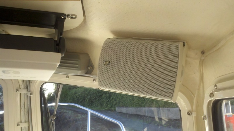

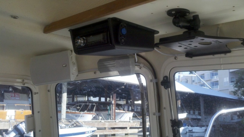

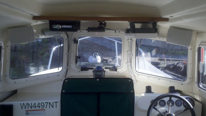

Here's what I did, but I'm not sure if your speakers are box or if they need to be mounted in a box.
These are out of the way enough that when sitting behind the wheel, they don't block visibility at all. I thought about the back corners of the cabin, but they were too easy to hit our heads on and would also be blasting the person in the aft dinette seat.
Also, they're shielded, so they have very little effect on the compass. Another pair we tried (Polk) were "shielded" as well, but would affect the compass from several feet away.

Those are PolyPlanar MA7500. They come with a metal bracket that allows for tilt adjustment. The part of the roof I attached them to has a small amount of core, enough that I could drill about 1/2" deep pilot holes for the screws I used (I think they were stainless #8 1/2" pan heads). Different years had different core configurations in the roof. Fortunately, mine already has a roof penetration at the radar arch mounts, and I could visually check for core there before drilling.
Your boat may not have core here, and in that case you'd want to do something else!
