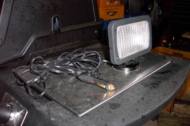

Know what you mean about losing night vision. I try to use just enough light for the task. Save the 2MIL CP light for turning night into day. I took the cheap route and could not be happier. Cost was eleven dollars. Found a magnetic mount 55W halagen light at WalMart.
Throws a good amount of 160* light for night moves/docking/fishing. Sticks great to the plow anchor and hangs down out of sight from the helm. There is no better place for a forward mounted fixed light IMO. No Glare in the windows as it is below deck level and no holes in the boat. Has a workboat look to it. Fused 15 ft wire runs under the unused anchor deck pipe.
If I plan on using the anchor, the light then sticks on top of the deck pipe. It comes with a cig adapter but can be hard wired. I hard wired in a three socket cig adapter to the circuit breaker for the windlass. The adapter is on the starboard side of the fuse panel. Then I can cycle the light on and off with the breaker or anything else like the oscilating fan. I like the cig plug. If I boat three weekends during the day, leave the light off of the bow of the boat. If I overnight or find myself out after dark? Pop it on. EASY...
If needed I have a cig adapter by the batteries. So this light can be used as a fish atractor, cockpit light or an excellent maintenance light if you need to do any engine work after hours. Want a side docking light? Stick it on the roof grab rail. I think it will stick to the window sill as well. It has a swivel base. I even use it on my garden tractor. Get a flat at night on the tow vehicle or trailer? This light is what you want. Cheap Thumbs Up Versatility Thumbs Up
The pic in my album is lame. When I get out I'll try to get a pic of the light in action. Life has been keeping me busy...

PostPosted: Fri Apr 22, 2005 11:42 pm    Post subject: Reply with quote
Here is a pic of the magnetic base light. About the size of the factory cockpit light. Why yes, that IS real gold on that cig adapter. The red LED light shows fuse is good and power is available. The last pic I posted didn't work. Soooo if not here look on page 3 in my album.
