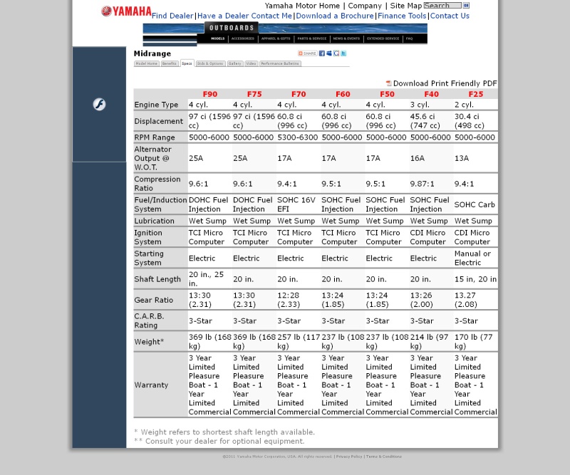

PostPosted: Thu Jan 05, 2012 6:57 pm    Post subject: Reply with quote
unless it's changed, the 70 hp and 90 hp Yamahas are the same block (and therefore displacement) and will have the same performance at lower rpm until the extra 15 hp kick in at higher rpm ranges.
That's the rub, Joe. Wink
The F70 uses the same block as the F50 and F60 but shares a similar gear ratio to the 75/90.
Compare the displacement of the 50/60/70 to the 75/90.
Will she have the "oomph" to power through surging tides and bar crossings ?
On a heavy boat, will that strain translate to a shorter life expectancy ?
PostPosted: Fri Jan 06, 2012 12:41 am    Post subject: Reply with quote
Ye, Pete, your absolutely correct!
The F75 and F90 do have the same block, while the new F70 has the smaller block, and my muddy thinking didn't catch it in the rush to judgment! Embarrased
I was thinking of the older comparison, not the newer, and would definitely try the 13"P 4B first with the new, smaller block, F70 motor.
Thanks for the correction and extra information! Wink
