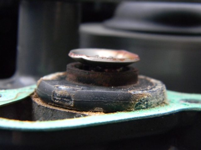

I was going to replace the thermostat in the starboard engine and then see what would happen with a new fuel pump in the port engine and a new thermostat in the starboard engine. BUT after finding that the starboard engine thermostat was stuck open and looked really grungy (see photo), I decided to replace the port engine thermostat. I hope to run them on the lake soon.
I did take apart the port engine fuel pump and found that it seemed to be in good shape, but that there are rubber seals in the unit that could deteriorate and leak if old enough or damaged in some way.
I don't know if I'm adding an image or not. If it isn't shown on this post I will place it in the Wilma Lee folder. Thanks again to everyone's input.
