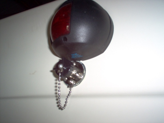

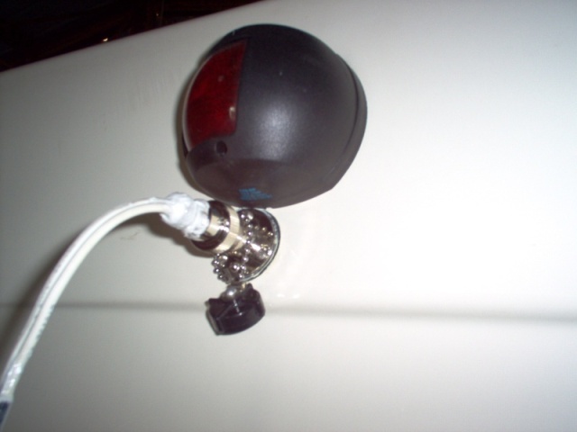

I put this fitting on the port side of the TomCat. The wire inside goes to the battery bank. The outside wire is connected through the 7 pin RV type plug to the trucks hot charging pin. It's only hot when the truck ignition is on. Uses the truck voltage regulator.
The charging wire stays with the trailer when the boat is launched. I run the Norcold and the Waeco freezer while traveling down the road.
Brent

I don't have part numbers. I use the 7 pin RV plug on the back of the truck to plug in the boat trailer lights. It also contains a 12 volt hot lead. I wired the 12 volt lead to continue through the boat plug. Then about 12' of #10 wire to the trolling motor plug, which is under the port navigation light ( see the pic ). Inside the boat, the #10 wire continues to the port battery bank ( 3, group 27 batteries ). The port battery bank serves the Norcold Refer. and the Waeco Freezer. Also is the start for the port motor. In addition we have 90 watts of solar panels on the cabin roof. These are also connected to the port battery bank. The house battery bank ( 2, group 31 batteries ) is for everything else, plus starboard motor starting. Its separate from the port bank, but can be switched together if necessary.
