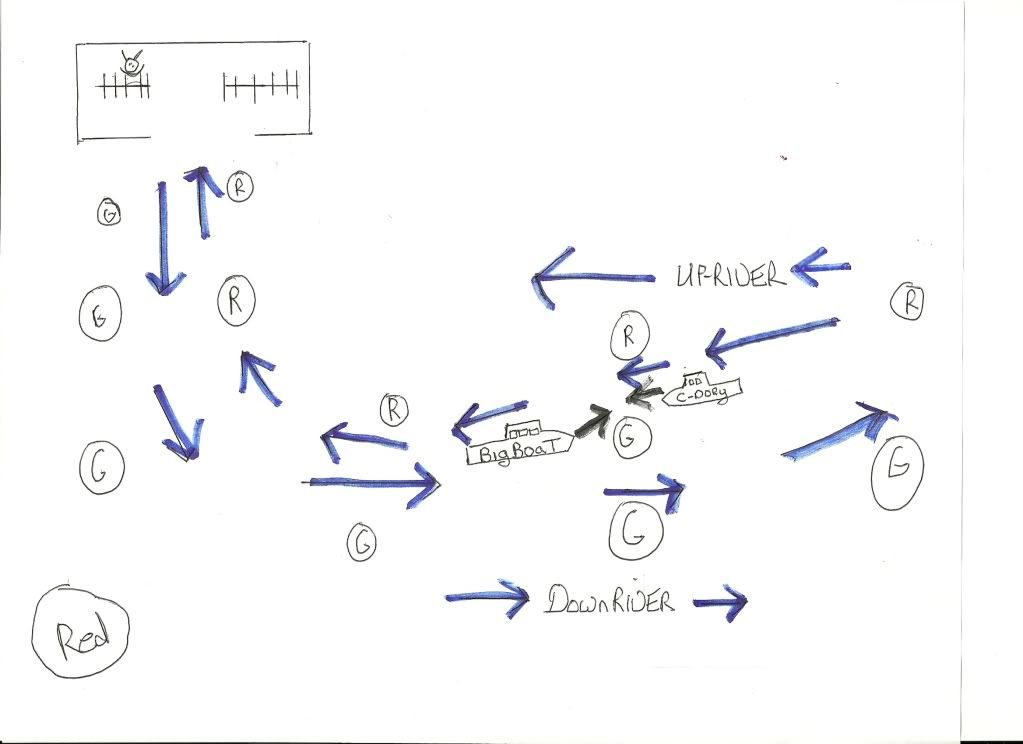

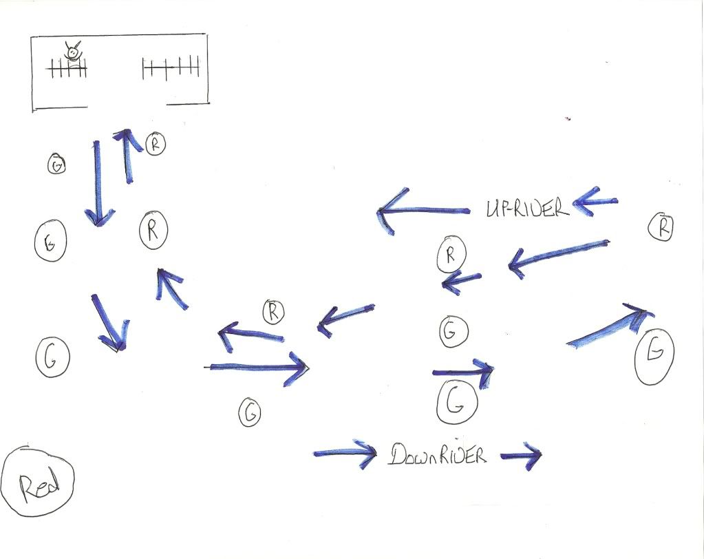

Here is a question, today i was almost in a collision with a big boat operated by some guy with girls in bathing suits and would of been if i hadn't turned to avoid the near head-on collision. I am 100% sure in was in the right ( thats why i am asking here..) . I was returning to the marina . headed up-river with the red can on my right, at this particular spot there are two green cans and one red can. My understanding is that when headed downriver leaving the marina the boater stays on his left, that means to me the extreme left which would be to the right of the second green can from the red can.This boater ( see diagrams ) proceeded to navigate to the right of the first green can from the red can. One other thing of importance is that the distance between the red can and the first green can is marginal, there is really isn't alot of room.
I tried to illustrate what occurred in the two diagrams, i think the other boater was incorrect . Tug

Guy got lost eyeballing the girls instead of oncoming traffic...happens every weekend 'round here...just part of the game...once, I can let it go..same guy twice..i get ugly. looks like he should have passed between the two greenies. Be grateful that you were on your gaurd yourself. I would rather be safe and damage free than right anyway. Evryone blows it once in a while...hey, he could be just one discourteous Fck. Get more of those every year. Newbies who know nothing of tradition and manners.Hey, ya got home safe..a successful voyage on any day.

I don't know for sure, but seems strange to have a green can in the middle of a channel, and between a red and green pair. If I was heading out of the marina and saw that arrangement, I would probably stay between the red and green and disregard the second green to stbd.
Also, I am a firm believer in the rule Barry mentioned, called "Tonnage Rules" and it is also on the books as "Must do everything possible to avoid a collision, even if you are in the right"

Harvey.......i think the idea behind the red can ,green can and another green can is to channel returning / upriver boat traffic to the extreme Starboard side of the river before the shipping channel narrow upriver to prevent undue boat traffic congestion. Tug

I agree that the 2nd Green can is confusing (although it sounds that "local" knowledge of its' reasoning is thought to be known...an "outsider" might not understand it).
I too would be more likely to pass between the red and middle green can thinking that it is certainly the desired channel and not willing to risk the confusion of the outer green can.
One other aspect that has not been discussed is "Rule 14 that power vessels proceeding downbound with a following current shall have the right-of-way over an upbound vessel, shall propose the manner and place of passage, and shall initiate the maneuvering signals prescribed by Rule 34(a)(i),as appropriate".

David is correct that Rule 14 applies:
Unless otherwise agreed [Inld] When two power-driven vessels are meeting on reciprocal or nearly reciprocal courses so as to involve risk of collision each shall alter her course to starboard so that each shall pass on the port side of the other.
(b) Such a situation shall be deemed to exist when a vessel sees the other ahead or nearly ahead and by night she could see the masthead lights of the other in a line or nearly in a line and/ [Intl] or both sidelights and by day she observes the corresponding aspect of the other vessel.
(c) When a vessel is in any doubt as to whether such a situation exists she shall assume that it does exist and act accordingly.
(d) Notwithstanding paragraph (a) of this Rule, a power-driven vessel operating on the Great Lakes, Western Rivers, or waters specified by the Secretary, and proceeding downbound with a following current shall have the right-of-way over an upbound vessel, shall propose the manner of passage, and shall initiate the maneuvering signals prescribed by Rule 34(a)(i), as appropriate. [Inld]
I assume that where you are located is one of the "Western Rivers". Generally vessels approaching head on, each goes to the Stb. so as to pass port to port.
Generally if an alternate passage is indicated there will be a buoy with red over green over red, or green over red green--the top color indicating the Preferred channel.
F. Junction Buoy (RED OVER GREEN): means two channels are coming together and you pass to the left of the buoy as you travel upstream.
G. Junction Buoy (GREEN OVER RED): means two channels are coming together and you should pass to the right of the buoy as you travel upstream.
