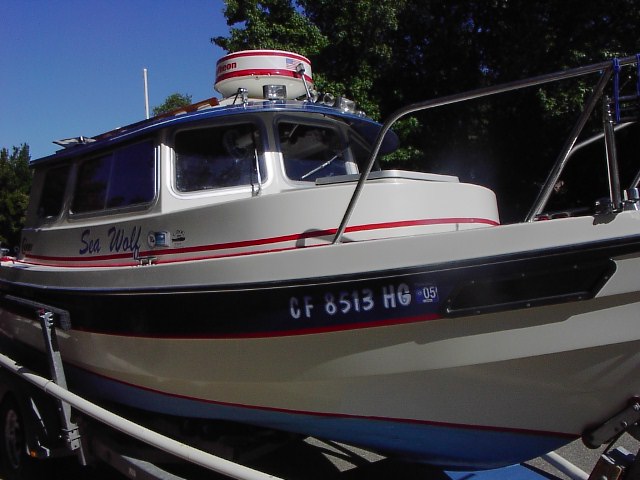

Foe myself, I'd make the paint line 1-1/2 inches above the waterline, then add a contrasting trim line out of plastic trim tape to separate the colors and make a contrast.

The Sharpie and 4 corner method. You place the boat in the water and mark each corner with a Sharpie then adjust to your needs. I like Joe's method on accent pinstriping, too. Very clean and sharp looking on his boat
