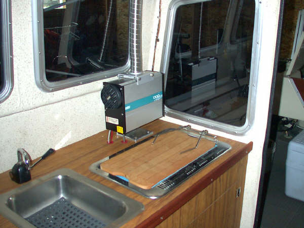

PostPosted: Mon Oct 18, 2010 6:21 pm    Post subject: Reply with quote
I finished the install of the 1300 on saturday. Not easy, but if I can do it most anyone can. Mounted it as high as I could on the wall between the sink cabinet and the cooler but the fuel bottle still ended up being about an inch too tall. So had to buy the larger, but shorter bottle. Fired it up and it took right off. Not as noisy as an espar but you can hear the pump thump. I did put on about 14 inches of duct with a slight bend to exit under the sink. The overheat sensor clicked off a couple times but after I shut it down. It won't fire again unless you reset the sensor. Hasn't done it since but I think the problem is probably not enough free combustion air going through the openings in the galley cabinet. Going to experiment a little. Might have to prop the door open an inch or so. But the thing heats well. Can't wait to get up to Kingston friday and try it out on the water. The exhaust is right at the top of the trailer guide rail but I am surprised the exhaust fitting doesn't really get all that hot.

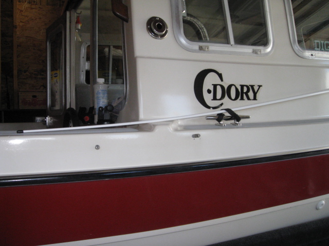

PostPosted: Mon Oct 18, 2010 7:37 pm    Post subject: Reply with quote
I've had 2 Wallas 1300 installations, the first on Snoopy-C, and the second on C-Miner (my current C-Dory 22). I installed both in the same place and in the same manner. Only difference is that on Snoopy, I ran the exhaust through the roof, and on C-Miner through the cabin side behind the rear window. Both have performed flawlessly.
