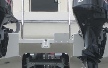

Has anyone put a kicker on a Tomcat? I have a 6hp Suzuki and I was thinking of using it as a kicker and also a motor for the dinghy but I wonder how it would fit between the twins.

Yes, that's the idea. Since the waterline when at rest or at slow speeds is only 10-12" below the top of the motor bracket, a short shaft should be fine. I was picturing something somewhat permanent off to one side so the ladder could still be used.
Something like this.

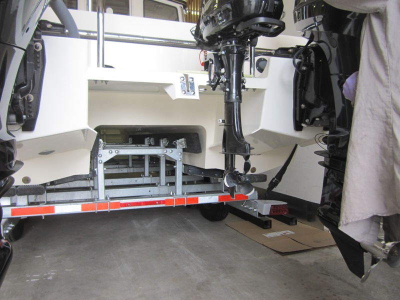

I'm sort of looking at this as a place to store the dinghy motor but available to use for trolling as desired. If I position it just right (4-6" higher than in the photo) it may not need to be raised at speed.
