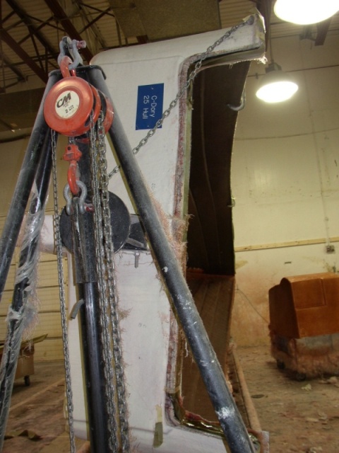

Journey On a 2005 C-25 has a high density foaf transom and balsa between the inner and outer hull.
The pics were taken by my daughter during construction. The green is the top edge of the trasome core, and the lighter brown is the balsa core.
