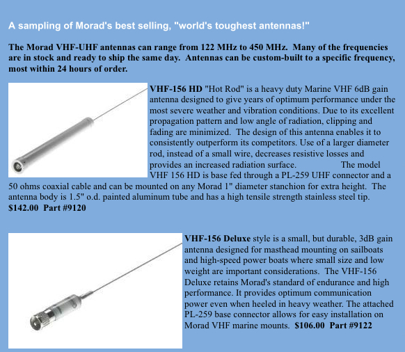

I have had several VHF antennas, from el cheapo from West Marine, a Digital 4.5 ft, and now a Morad.
Morad is a company that makes a very tough series of antennas. They are used on most PNW fishing boats, Coast Guard patrol boats and other public service craft.
Here is a copy of the description from the web site.
I visited the factory in Seattle and was impressed with the construction and employees. I have installed the 4.5 ft VHF 156 HD on my trawler on a 5 ft extension. The extension is 1in thick wall aluminium tube painted white. Very strong. Each antenna is tuned to a SWR of 1.15 during construction. There is a PL259 connector at the antenna base and any of the three sizes of antenna cable can be used.
Greg on Red Fox is running a Morad VHF 156 HD on a pole mounted on the cabin side. He uses the pole as a handhold!
The smaller antenna looks like it would be good on smaller boats.
I bought mine at Fisheries Supply, Seattle for somewhat less than the list price shown. Initial tests on receive only while my boat is under a metal roof are good. I cannot report range until later this summer.
And no, I don't own any stock in Morad!

Larry,
We are running with 3 Morads. (2VHF + AIS) and functionally they have worked fine for 3 seasons now. Only problem we have had was one connector issue (mine) and now I have noted that some paint is flaking on the white mounting tube which is a minor thing to deal with.
We use one of them as the courtesy flagstaff when in Canada.
(And they don't break even if they hit the roof of the dock) Embarrased

Merv,
Nice to know other Brats have good results with the Morad.
The Morad company makes a gold anodized aluminum tube mount that probably keeps its finish longer than the paint, but doesn't look as 'yachty'. I wanted the anodized but it was not available at Fisheries.
I plan on using mine as a courtesy flag pole too.
