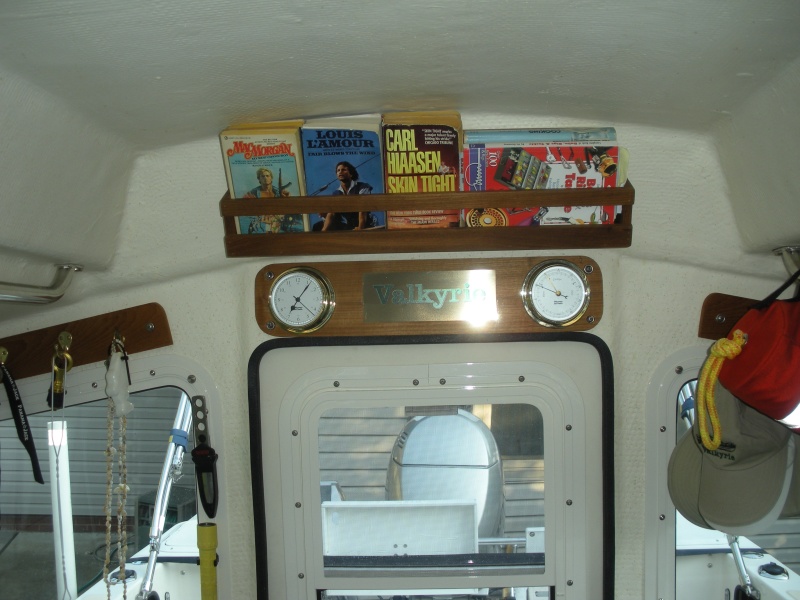

Mike,
Thanks for the picture, but everything seen in it is attached mechanically. The outmost pieces of teak use screws into the bulkhead, as does the Valkyrie nameplate with the clock and barometer. The bookrack is through-bolted. Only the paper towel rack is epoxied in place.
Regards,
Nick
