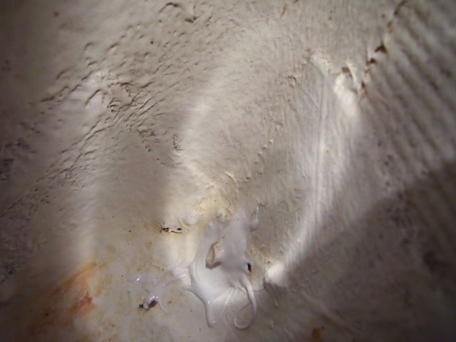

PostPosted: Mon Apr 26, 2010 11:07 pm    Post subject: picture of tube Reply with quote
Go to this album for a pict (021) of the tube I installed. There's not much prospective. I should have dropped a penny in the picture.
http://www.c-brats.com/modules.php?set_albumName=anchor-locker-drain&op=modload&name=gallery&file=index&include=view_album.php
As I remember I did this in a Pensacola ship yard without many resources. The hole was already there and I think I used the tube off of a Great Stuff can. It fit just right. I coated the thing with 3m 5200 and cut it to length after installation. It sits about 1/2 inch off the bottom of the locker. I think it drains fine because the attitude of the boat causes gravity to pull the water down to the lowest part of the locker...or maybe its because I'm going 20kts and the difference in air pressure pushes the water out (sorry I'm I'm a physics nerd). Anyway it cured the problematic leak.
Mike[/url]
