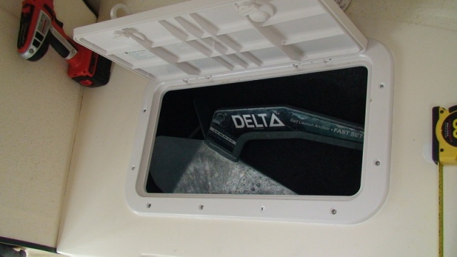

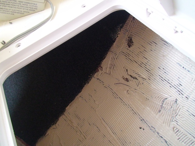

PostPosted: Sun Feb 15, 2009 1:23 pm    Post subject: V-Berth Storage Reply with quote
Hi All,
Just getting ready to do some more work on the new storage area. Thought I might share what I intend to do. We considered reserving the forward portion of the underbunk area for foam but have decided to install a third hatch and remove it all. Then sand smooth and line the entire area with marine carpet. Hoping this will provide noise insulation and enough traction to keep things from sliding around. I would be very interested in seeing how your projects turn out.

PostPosted: Sat Feb 28, 2009 4:07 pm    Post subject: V-Berth Storage Reply with quote
Just finished with the storage area. The carpet worked out pretty well. And its easy to work with. Here are a couple pics.

PostPosted: Sat Feb 28, 2009 9:15 pm    Post subject: Reply with quote
Karl;
Is there any concern with mold collecting in the forward compartment's carpeting?
Have you also considered the abrasion the anchor(s) may cause on the inner hull?
I have found some rubber/foam door matts at places like 'Bed Bath & Beyond' to work very well in protecting my hull from my second anchor bouncing around below deck. They aren't too expensive either and when you thru with them you can use them as anti-fatigue matts at the work bench, etc..
