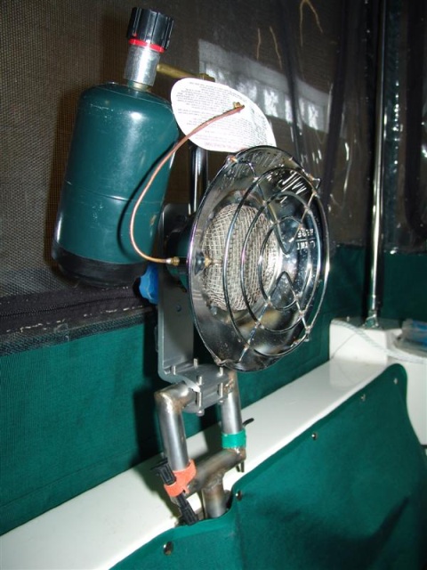

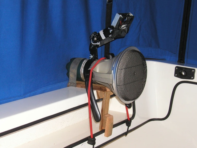

I first looked at the Buddy heater but was afraid that it would tip over and didn't see a secure way to mount it. We got the Mr. Heater for $25.00 on sale and I adapted it to my grill mount. It can also function as a stove. I got my idea from something similar that oldgrowth of C-Voyager made (below). And it does get good ventilation when we are under way. A window cracked open and the gaps around the camperback. We also got a Garmin radar as well.
