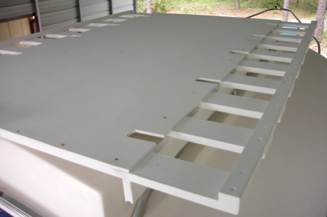

I made a roof rack out of cheap wood. Cost less than any mount system. Painted white. Pops on and of easily . No alteration to the boat. Very strong. Can hold anything you care to put up topside. Makes a great sun deck. Makes a great shade for the cabin in the hot South. A few pics in my album.
Chris
PostPosted: Wed Nov 19, 2008 12:07 am    Post subject: Reply with quote
Here's Chris' roof rack and a LINK to his album with several more photos.

Sea-Wolf Joe, breausaw:
Thanks for the comments. I am far from any metal fabrication so cheap pine wood is what I tried. If the prototype didn't work I wouldn't be out much. I used a router to make a u-shaped channel on the two base rails. This allows them to balance above the rails. The proper height side rails will allow the middle section to just barely clear the center roof. With a load it just kisses the center for support. The five notched out areas allow access to five band clamps per side and hold everything with no holes drilled in the boat. The band-clamp screws are on the backside of the base rails. They go thru slits cut midway in the base rails. I only installed four per side and it is very strong. Brass screws hold all the parts together. I decided to keep the middle deck narrow to allow airflow when cruising waterways and on the highway. The low profile doesn't seem to noticeable, wind wise.
The slated edges allow good hand holds as well as lashing points. My boat came with very large dock bumpers. I tie one inline with the helm seat. When I motor, I just pop it on the roof without untying and it rides in the channel of the open slates. Someone here on the site suggested using paint when I asked for a coating/sealant recommendation. I used a few coats of some latex house paint I had and it is quite durable. No touch-ups yet. I think the white rack with the white boat looks good. A better paint match might be even better.
When I laid it all out on the roof I would get the spacing parallel with the cabin top on one side. Then I would measure the other side and find it off! After a bit of head scratchin. I realized the two metal rails taper in slightly as they go forward. Not much of a woodworker, but I couldn't be happier with the utility of how it turned out. Especially for the small $$$ invested.
