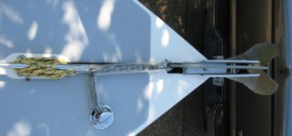

PostPosted: Sun Jan 13, 2013 11:33 am    Post subject: Padding on deck under the chain? Reply with quote
Look in my album under mods. Easy and inexpensive. Held in place by a couple of dollops of Marine Goop (Canadian Tire).
Martin.
Posts: 5922
PostPosted: Sun Jan 13, 2013 12:19 pm    Post subject: Re: Padding on deck under the chain? Reply with quote
Martin.
Here's the image from Martin's album.
