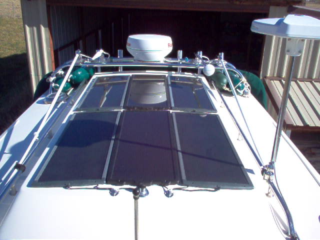

Our solar panel setup
6 x 15 watt panels, total of 90 watts. They are from Northern Tool, cost $80.00 each on sale. The charge controller is a MMPT type boost controller. The cost was about $100.00 from eBay.
The charge controller is the larger panel in the center of the overhead.
We also use solar panels on our 5th wheel trailer (2 x 120 watts) and on our truck camper ( 1 x 75 watts).
