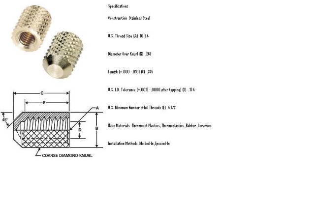

Threaded-inserts are one way of securing your head. Drill out the holes oversize. Bed the inserts into thickened epoxy(ala Dr. Bob). Secure with stainless machine screws.

I found a good source for those threaded inserts www.mcfeelys.com I was going to try some of these inserts without epoxy first. I have multiple thread type choices and was hoping someone could tell what type of wood C-Dory probably used for core material below my marine head. That way I can make the best thread choice.
