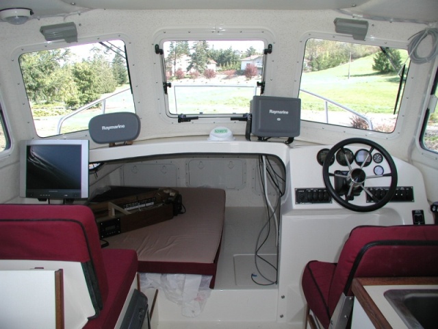

I think Roger (Dreamer) set his laptop and plotter up in what I would consider the ideal mode:
The chartplotter is set up for the Helmspersons view, and the laptop it set up for use by the person in the portside forward facing seat that is the "Navigator".
This not only makes more sense considering the physical dimensions and capabilities of the two units, but it also helps train and utilize the skills of the other person, a great plus for safety in the event of the disability of the Helmsperson.
Dreamer's Helm and Navigation station.
