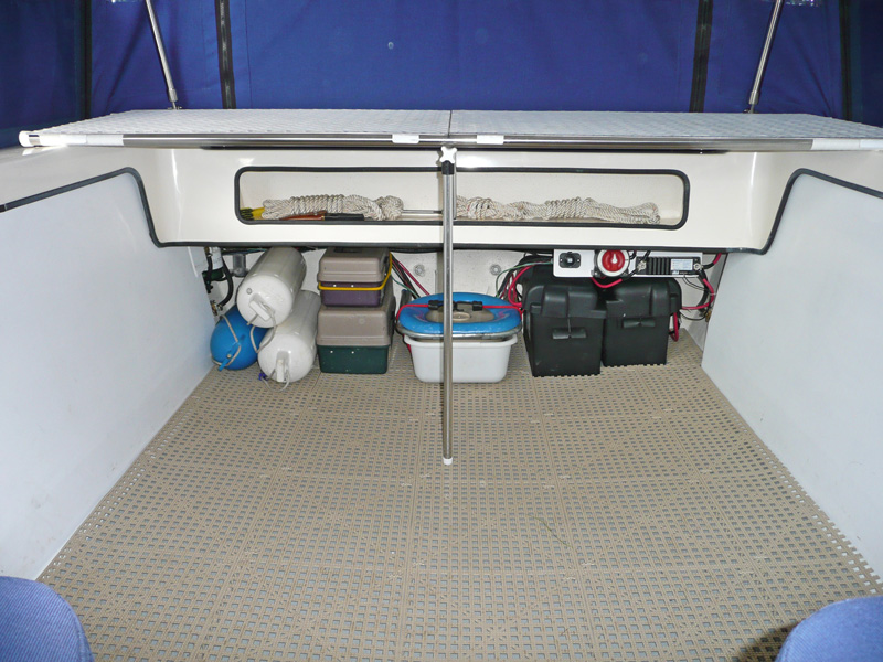

I have the same setup as Adeline. I did put a LCD indicator light on the dash that lights up when I have my switch on to combine the batteries. The light acts as a reminder so I will not forget to turn the switch off. It is too easy to forget to turn it off, and can lead to the discharge of your starting battery.
When I am charging from a battery charger, I usually hook the charger to the house bank and the ACR will combine the batteries automatically.
When I extended my boat I moved it to under the engine well just above the batteries. Before it was inside the cabin because my batteries were under the port seat. I have had this setup for two years and haven’t had any trouble with it.
