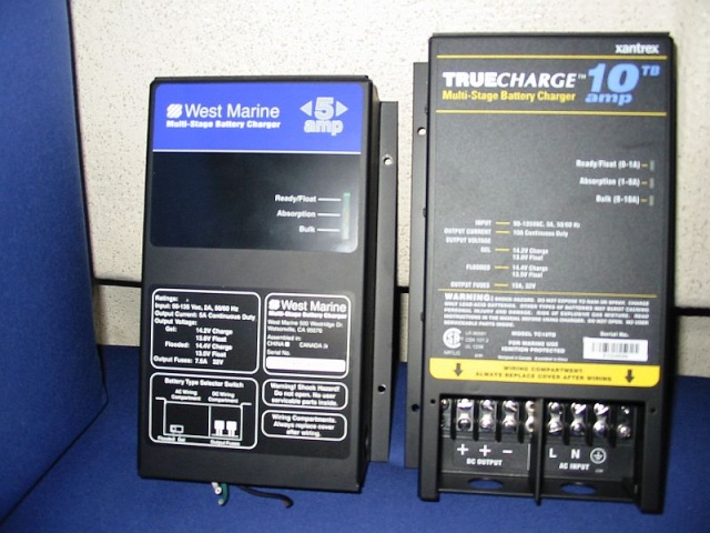

PostPosted: Thu Oct 25, 2007 3:50 pm    Post subject: Reply with quote
I installed a "smart" charger and simply leave it on all the time. It monitors the voltage(float) and only charges when it has dropped to a preset level. I replaced the older 5 amp West Marine Brand(Statpower) with the 10 amp Xantrex for faster recovery on the water. The reason I prefer these types is that I can mount them where I like(inside on the bulkhead) and size my wiring accordingly. As I recall, the Guests come with fixed leads which limit your mounting options. BTW, the 5 amp West Marine is available for 1/2 what I paid for it...$100.00 with all original packaging and manual.
Pete
