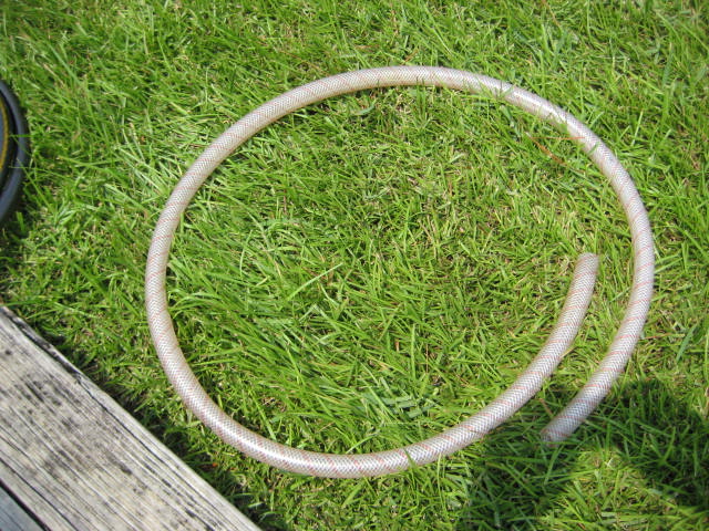

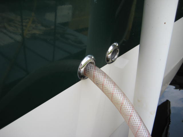

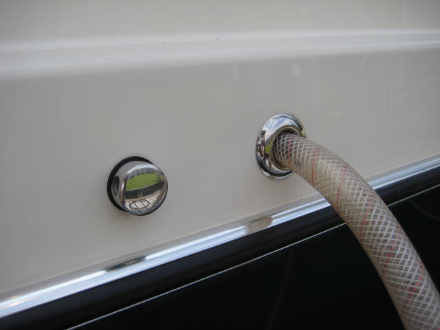

I have seen several "solutions" for the pumping out of sewage from the holding tank out of the thru hulls in the side of the Tom Cat and CD 25.
I have used 3/4" reinforced hose, which fits very snugly about 3/4" into the thru hull and makes a water tight seal. I have so far used a 6 foot piece of hose which will then go into a sewer fitting at a camp ground, or dump station. A smilar piece of hose can be used for the galley sink and shower sump, all channeled into a sewer fitting or RV sanitary tote. This will allow the boat to be used at a camp ground and sewage discharged without finding a marine pump out station. It also allows discharge in our home hoist into a sanitary tote (RV item) or even into the water at sea, without risk of sewage getting into the cockpit since the discharge fitting is above the gunnel.

That is not going to work in that the "Y" to the macerator is downline of the pumpout deck fitting. By the time the waste gets to the macerator, it is on the way out to the overboard discharge is my thinking.
The Valve has to be either one way or the other. If all you put into the holding tank is human waste and RV type toilet paper, there should be no need for maceration in order to pump out the tank.

The tubing I used was the standard re-enforced hose in 3/4" diameter, available at West Marine. What I first used was in my "hose" scrap bin. These hoses are used for pressure water systems primarly. I have used them for bilge discharge, raw water wash down, head intake etc.
I had a nylon fitting I was going to cut and file to fit the discharge fitting--but when the hose fit so well, it solved the problem.
I have used a macerator identical to what is in the C Dory to macerate and pump sewage about 25 feet thru a 3/4" hose from my RV to a sewer fitting at a home before I had a specific RV sewer dump, as I have at my home currently. Based on this, I believe that the pump might push it to the porti potty dump station at Powell. In my use at home, I there was plenty of pressure to pump the sewage to a "RV septic tote" which was about even with the deck level on the lawn. The porti potty dumps are about 3 feet above the deck, probably 2 1/2 feet above the fitting. I agree, the hand operated pumps at Powell are very slow--and that operating the macerator would be of no help. Do not run the macerator pump when it is dry--it will burn up the impellor.
