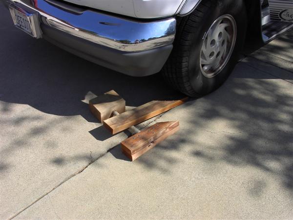

1" stainless 316 tubing is WAY too tough to bend on your own, IMHO!
You need the services of a professional railmaker to bend the stuff at the right raidi, etc.
I did put a bend in a short piece with my van back in 2003, but it was just a kink, as bends go:
Is there a railmaker near you?
It's great stuff, and also deserves 1st class welding to preserve it's strength at joints and attachment points.
