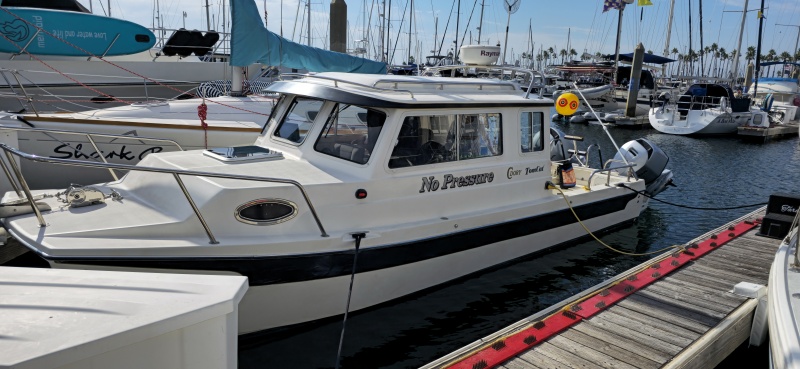

I'll have to try that next time. I waxed our Tomcat for the first time in about five years last week. I used Turtle Hard Shell paste wax. I'm not sure how long it will last, but at least the boat is pretty. Smile
